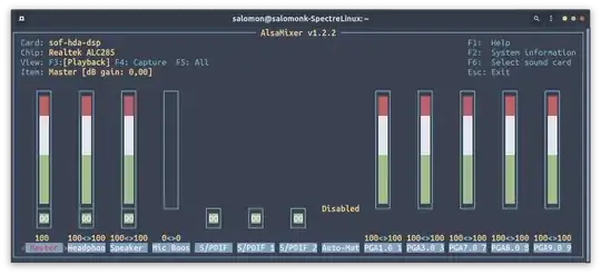

Current alsamixer view:
AlsaMixer
Since the headphones are working, I suppose this is a "pinning" problem.
I suspect this line reflects the problem:
snd_hda_codec_realtek ehdaudio0D0:    speaker_outs=0 (0x0/0x0/0x0/0x0/0x0)

git clone -b stable-v1.6 https://github.com/thesofproject/sof-bin.git
aplay -l
card 1: sofhdadsp [sof-hda-dsp], device 0: HDA Analog (*) [] Subdevices: 0/1 Subdevice #0: subdevice #0
Although you state that you "Made sure everything is unmuted and with volume in alsamixer", on the last picture (AlsaMixer for Realtek ALC285) the speaker is muted. Use your arrows to highlight the speaker volume and press "m". This should replace the "MM" with the actual volume und thus unmute your speaker.
