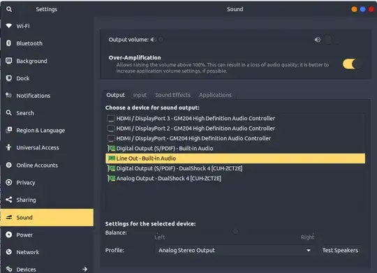

I use my "Line Out - Built-in Audio" for my speakers, but for some reason, every time I reboot my computer, it changes by default to "Digital Output (S/PDIF) - Built-in Audio".
The funny thing is that, if I unplug and re-plug my speaker connector, the channel changes by itself to "Line Out" without me having to do anything.
What could I do so that I can stop doing this annoying step every day?
