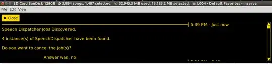

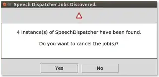

The current project is a music player in Python so why not have it check when the speech-dispatcher gremlins show up? Then it displays a message:
Here's the python code to serve as a guide:

Near the bottom is info.cast() function. It zooms down a broadcast message. It's kind of like print() command for a GUI application:
check speech dispatcher info.cast()
