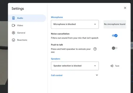

I had a similar issue where after restarting pipewire and pipewire-pulse the microphone would stop working in Google Meet. When I tried changing it the settings would show a few error messages:
Microphone is blocked
No microphone found
Speaker selection is blocked
pipewire pipewire-pulse Chrome Google Meet Error: Microphone is blocked. No microphone found. Speaker selection is blocked.
Following Michael's answer I was able to fix the issue by killing the Chrome Audio Service and then reloading Google Meet:
