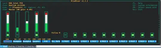

my alsamixer output for the microphone is peculiar.
