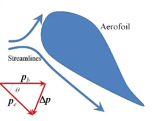

We can do a back-of-the-envelope estimation of ram pressure in this case: see my drawing below of a simple aerofoil with a significant angle of attack being held stationary in a wind tunnel. I'm going to put some numbers to Sklivvz's description:
Simple Aerofoil
Let's suppose the airflow is deflected through some angle $\theta$ radians to model an aeroplane's attitude (not altitude!) on its last approach to landing or as it takes off, flying at $300 \, \mathrm{km\,h^{-1}}$ airspeed or roughly $80 \, \mathrm{m\,s^{-1}}$. I have drawn it with a steep angle of attack. Air near sea-level atmospheric pressure has a density of about $1.25 \, \mathrm{kg\,m^{-3}}$ (molar volume of $0.0224 \, \mathrm{m^{-3}})$. The change in the momentum diagram is shown, whence the change in vertical and horizontal momentum components are (assuming the speed of flow stays roughly constant):
$$\Delta p_v = p_b \sin\theta;\quad\quad\Delta p_h = p_b \,(1-\cos\theta).$$
At the same time, the deflecting wing presents an effective blocking area to the fluid of $\alpha\,A\,\sin\theta$ where $A$ is the wing's actual area and $\alpha$ a scale factor to account for the fact that in the steady state not only fluid right next to the wing is disturbed so that the wing's effective area will be bigger than its actual area. Therefore, the mass of air deflected each second is $\rho\,\alpha\,A\,v\,\sin\theta$ and the lift $L$ and drag $D$ (which force the engines must afford on takeoff) must be:
$$L = \rho\,\alpha\,A\,v^2\,(\sin\theta)^2;\quad\quad D = \rho\,\alpha\,A\,v^2\,(1-\cos\theta)\, \sin\theta.$$
If we plug in an angle of attack of $30$ degrees, assume $\alpha = 1$ and use $A = 1000 \, \mathrm{m^3}$ (roughly the figure for an Airbus A380 wing area), we get a lifting force $L$ for $\rho = 1.25 \, \mathrm{kg\,m^{-3}}$ and $v = 80 \, \mathrm{m\,s^{-1}}$ of $200$ tonne weight. This is rather less than the takeoff weight of a fully laden A380 Airbus (which is $592$ tonnes, according to the A380 Wikipedia page), but it is an astonishingly high weight just the same and within the right order of magnitude. As I said, experiment is Queen here. We see that the wing's effective vertical cross-section is bigger than the actual wing's by a factor of 2 to 3. This is not surprising at steady state, well below the speed of sound flow: the fluid bunches up, and the disturbance is much bigger than just around the wing's neighbourhood. So, plugging in an $\alpha = 3$ (given the experimental fact that the A380 can lift off at 592 tonnes gross laden weight), we get a drag $D$ of 54 tonne weight (538kN) - about half of the Airbus's full thrust of 1.2MN, so this ties in well with the Airbus's actual specifications, given there must be a comfortable margin to lift the aeroplane out of difficulty when needed.
In these F4 / C5 grade winds (and up to three times faster in normal flight), we see, therefore, there simply isn't any shortage of lift. The aeronautical engineering problem is more about keeping this plentiful lift stably directed upwards and allowing the aeroplane to hold a steady attitude and keep any torques arising from lift nonuniformity from flipping the plane over.
As the aeroplane picks up speed, the ram pressure calculated above is proportional to the square of the airspeed (see my answer to Drag force at high speeds ), so that at full speed the effect more than accounts for the drop in air density and the shallower angle of attack - we cannot make this downwards ram pressure without overcoming the much greater horizontal hindwards component - drag - so that is important to fly with low angle of attack for good fuel efficiency.

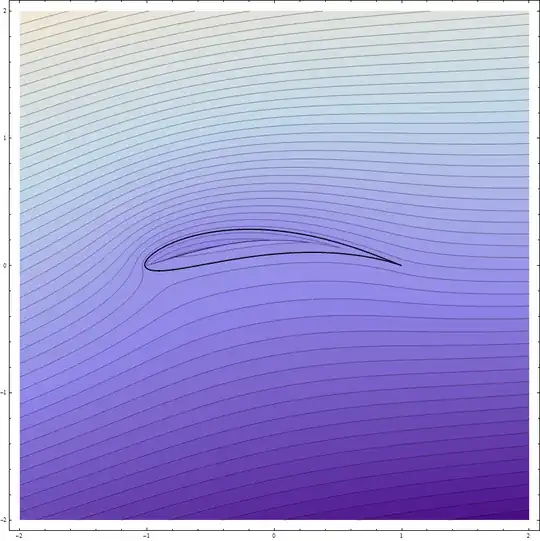

#A Joukowsky Aerofoil Calculation and Errors in Wonted Application of Bernoulli's Principle to Wings
We look at a 2D calculation of lift by Bernoulli's principle or, equivalently, by application of the Theorem of Blasius. The common misconception here is that airflows split at the wing's leading edge, and two neighbouring particles will reach the wing's lagging edge at the same time so that the upper particles must fare the curved surface at higher speeds and, therefore, the pressure on the upper wing surface is less. Actually, the upper path particles are sped up much more than this explanation implies and reach the wing's lagging edge well before their lower-path-faring neighbours. See this wonderful video from the University of Cambridge, particularly at about 50 seconds in. This fact shows that the circulation $\oint_\Gamma \vec{v}\cdot\mathrm{d}\vec{r}$ around the wing's surface $\Gamma$ is nonzero, a fact which we intuitively expect from simple theory (as shown below) and which is amply confirmed in experiment: see the video, or go to the end of a runway of a large airport on a damp day so that you can let big commercial jetliners fly over you at about 50m height (take your earmuffs). On a damp day, you will see vortices breaking off the swing' outer edges, will see them swirling in the damp air for many seconds in the aeroplane's wake and, if you take your hearing protection off after the aeroplane has passed, you will hear the vortices crackling in the air, sounding a little like waves washing on the beach. This is much more fun than it sounds when your children are badgering you to do such a thing, and, from the sights and sounds, I learnt heaps more from doing it than I thought I would. Even though the following calculation has an air of theoretical soundness and "first principles" to it, it is important to understand that it too is an experimental model: the circulation is forced into our description, motivated by the confirmation of the former's existence by experiment. The Kutta-Joukowski Condition (see Wikipedia page for Kutta Condition) as well as the Wikipedia page for the Kutta-Joukowski Theorem is little more than an ad-hoc experimentally motivated fix: it is simply this. When we model the flow with a Joukowski aerofoil (described below), there is a sharp, lagging edge on the wing. This begets a singularity with unphysical, infinite velocities. However, by postulating and choosing the right circulation in the flow, we can put a stagnation point at the lagging edge, thus cancelling the singularity, regularising our solution and also forcing the experimentally observed condition that there is only ever one stagnation point at the wing's leading edge, never elsewhere.
Another way to look at this experimentally motivated condition is well explained in this answer to the Physics SE question Does a wing in a potential flow have lift?. An irrotational, inviscid, incompressible flow cannot alone lift a wing. We add circulation to "fudge" a compensation for this theoretical lack: viscosity is "nature's way of enforcing the Kutta-Joukowski condition".
So we begin with the complex variable method (see the Wikipedia page for "Potential flow" in the section "Analysis for two-dimensional flow") to study a potential flow, i.e. irrotational ($\nabla \wedge = \vec{0}$) velocity field $\vec{v}$ with a potential $\psi$ such that $\vec{v} = -\nabla \psi$ that is also incompressible (continuity equation $\nabla\cdot \vec{v} = \nabla^2 \psi = 0$). See also the Physics SE questions Finding Stagnation Points from the complex potential ).
The main method here is to use the Joukowski transform:
$$\omega(z,\,s_z,\,s_\omega) = \frac{ s_\omega }{2}\left(\frac{z}{ s_z } + \frac{ s_z }{z}\right)$$
to map the potential flow corresponding to a spinning, offset cylinder (see the NASA page "Lift of a Rotating Cylinder") into the flow around the image of this cylinder under the Joukowsky transform. The truly weird Flettner Aeroplane actually used spinning cylinders rather than wings to fly successfully. The Joukowsky transform maps the circle $|z| = s_z$ onto the real axis between the points $\omega = \pm s_\omega$ in the $\omega$-plane; this section of the real axis between $\omega = \pm s_\omega $ is then the branch cut for the inverse Joukowski transform. The Joukowsky transform is a two to one mapping, and the branches of the inverse Joukowski transform map the whole $\omega$-Riemann sphere (if we define the stereographic projection so that $|z| = s_\omega $ is the $\omega$-Riemann sphere’s equator) separately to the inside and outside of the circle $|z| = s_z$ in the $z$-plane (which outside and inside can be thought of the Northern and Southern hemispheres of the $z$-Riemann sphere, if the stereographic projection is chosen so that the circle $|z| = s_z$ is the $z$-Riemann sphere’s equator). The $\omega$-Riemann surface is made by slitting two copies of the Riemann sphere along the branch cut and stitching the edges together to get a double cover of genus nought for the $\omega$-Riemann sphere. For this problem, I define the branch cut as slightly different from the real axis section between the $\pm s_\omega$. I define it as the path:
$$\operatorname{Im}(\omega) = h \cos\left(\frac{\pi}{2} \operatorname{Re}(\omega)\right)$$
between the two branch points with an adjustable height parameter $h$, for reasons that will become clear.
The radius $r$ of the spinning cylinder radius is chosen so that the cylinder surface passes through the point $z=+s_z$, which is the image of one of the branch points in the $\omega$ plane. This achieves the sharp edge that becomes the lagging edge of our aerofoil.
The complex potential for the spinning cylinder is:
$$\Omega(z) = v \,e^{-i\alpha}\,\left(z- \delta\right) + \frac{r^2 \,v\, e^{+i\alpha }}{z- \delta } + i\,a\,\log\left(z - \delta \right)$$
where $\alpha$ is the angle of attack, $\delta = \delta_r + i\,\delta_i$ is the offset, and $r$ is the radius of the cylinder steeped in a uniform flow which converges to $v$ metres per second along the positive real axis, as $z\to\infty$. The logarithm and dipole terms put a branch point and pole at the cylinder’s centre, so the flow is perfectly valid outside and on the cylinder. $a$ is the circulation. If we let $\phi$ stand for the angular coordinate labelling the cylinder’s edge, there are two stagnation points on the cylinder with angular coordinates $\phi_\pm$ where $\mathrm{d}_z \Omega(z) = 0$, i.e. when:
$$e^{i\,(\phi_\pm - \alpha)} = -i\frac{a}{2\,v\,r}\pm\sqrt{1-\left(\frac{a}{2\,v\,r }\right)^2} = \exp\left(-\arcsin\frac{a}{2\,v\,r }\right).$$
Now, we map this flow to the $\omega$ plane and apply the Theorem of Blasius to the image of the offset circle so as to work out the lift on this image. The image can be plotted with the Mathematica command:
$$\small{\mathrm{P[\delta_r\_, \delta_i\_] := \\ ParametricPlot[\{Re[\omega[\delta_r + i \delta_i + \sqrt{(1 - \delta_r)^2 + \delta_i^2} Exp[i \theta]], Im[\omega[\delta_r + i \delta_i + \sqrt{(1 - \delta_r)^2 + \delta_i^2} Exp[i \theta]]\}, \{\theta, 0, 2 \pi\}]}}$$
and the result is drawn below in the $\omega$-plane for $s_z = s_\omega = 1$, $\delta_r = -0.1$, $\delta_i = 0.3$ (i.e. the spinning circle offset so that its centre is at $-0.1+i\,0.2$ and with a radius $r = \sqrt{(1 - \delta_r)^2 + \delta_i^2}$ so that its image passes through the branch point $\omega = +s_\omega = 1$ in the $\omega$-plane:
Joukowski Aerofoil
Now we come to the crucial Kutta-Joukowski postulate, an experimental "fudge". The sharp edge on the aerofoil above would normally map the flow in the $z$-plane so that there was an unphysical infinite velocity at this sharp point. In practice, it is seen in wind tunnel tests that the streamlines stay tangent to the upper surface and that there is one stagnation point at the wing's leading edge (intuitively, the air "crashes" here) and no other stagnation points on either the top or bottom of the wing. Sometimes, there is a small region of turbulence around the wing's lagging edge (as in the University of Cambridge video) (i.e. the incompressible potential flow model fails here), or the flow peels smoothly off the lagging edge. The way we achieve effects similar to experiment and "renormalise" our solution is to add the right amount of circulation $a$ to the flow so that one of the stagnation points on the spinning cylinder is mapped to the sharp edge (the branch point at $\omega = +s_\omega$) in the $\omega$-plane: the stagnation thus cancels the otherwise unphysical infinite velocities there and "regularises" our solution. With the radius of the cylinder chosen as $r = \sqrt{(1 - \delta_r)^2 + \delta_i^2}$, it can readily be shown from the equation above for the stagnation point positions that the circulation needed is:
$$a = 2 v\,\delta_i \cos\alpha + 2\,v\,(1-\delta_r) \sin\alpha.$$
This, then, is the wholly experimentally motivated Kutta-Joukowski condition. It is motivated by the knowledge that circulation is observed around wings, that there is experimentally only one stagnation point on the leading edge of the wing and the fact that the right amount of circulation can reproduce these experimentally seen results.
When this is done, the Blasius theorem lift calculation done around the transformed Joukowski aerofoil in the $\omega$-plane is:
$$\begin{array}{lcl}D_\ell - i\,L_\ell &=& \frac{i\,\rho}{2}\oint_{\Gamma_\omega} (\mathrm{d}_\omega \Omega)^2 \,\mathrm{d} \omega\\ &=& \frac{i\,\rho}{2}\oint_{\Gamma_z} (\mathrm{d}_z \Omega)^2 \frac{1}{\mathrm{d}_z \omega}\,\mathrm{d} z\\ &=& -\pi\,\rho \Sigma[\,\mathrm{residues\,of\,}\,(\mathrm{d}_z \Omega)^2 \frac{1}{\mathrm{d}_z \omega}\,\mathrm{at\,poles\,within\,}\Gamma]\\ &=& -4\,\pi\,i\,\rho\,a\,v\,e^{-i\,\alpha}\end{array}$$
where $\Gamma_\omega$ is the Joukowski aerofoil and $\Gamma_z$ the transformed aerofoil (i.e. the spinning cylinder). So there is no lift without circulation. It's worth stating again:
Now we substitute the Kutta-Joukowski condition to get:
$$D_\ell + i\,L_\ell = 8\,\pi\,i\,\rho\,v^2\,\left(\delta_i\,\cos\alpha + (1-\delta_r)\,\sin\alpha\right) \frac{s_z^2}{s_\omega} e^{+i\alpha}.$$
We now need to scale the velocities so that the relative airspeeds are equal in the $\omega$- and $z$-planes.
The above is the force per unit length (in a direction normal to the page) on the wing, and its direction is the direction in the $\omega$-plane. We have:
$$\lim\limits_{\omega\to\infty} \left(\mathrm{d}_\omega \Omega(\omega(z))\right) = \lim\limits_{z\to\infty} \left(\mathrm{d}_z\Omega(\omega(z))\right) \lim\limits_{\omega\to\infty} \left(\mathrm{d}_\omega z\right) = 2 \,e^{-i\alpha} v \frac{s_z}{s_\omega}$$
so we need $s_\omega = 2$ and $s_z = 1$, then $\delta$ will be a dimensionless parameter defining the offset of the $z$-plane cylinder as a fraction of its radius. But now the $\omega$-plane planform width of the wing is 4 units. Moreover, the above calculation yields the force per unit length (normal to the 2D flow). So, we divide the result for $s_\omega = 2$ and $s_z = 1$ by 4 and then scale up by the total wing area to get the total force on the wing. Furthermore, we need to rotate the flow in the sketch below so that the incoming flow is horizontal (i.e. in the direction of the aeroplane's relative air velocity) in the $\omega$-total force on the wing above becomes:
$$D + i\,L = \pi\,i\,\rho\,v^2\,A\,\left(\delta_i\,\cos\alpha + (1-\delta_r)\,\sin\alpha\right)$$
We witness the d'Alembert paradox: the perfect flow cannot model the drag. Now, let's put some numbers in. If we put $\delta = 0$, then the wing is simply the straight branch cut between $\omega = \pm 1$, so we have a version of the calculation I began with but now refined to take account of the full flow pattern. With $\alpha = 0.3$ (a little less than 20 degrees), $\rho = 1.25 \, \mathrm{kg\,m^{-3}}$, $v=80 \, \mathrm{m\,s^{-1}}$ and $A = 850 \, \mathrm{m^2}$, we get $L=643 \, \mathrm{tonne}$, pretty near to the Airbus's fully laden takeoff weight. If we chose the parameters $\delta_i = 0.2$, $\delta_r =-0.1$ to give a wing shape that does not seem too fanciful for a jetliner wing with the lagging edge flaps wound fully out for takeoff and landing (see the plot below) we get about $1200$ tonnes to lift for our $300 \, \mathrm{km\,h^{-1}}$ airspeed. Clearly, this is optimistic, and the over-reckoning arises from the assumption of equal effectiveness of the whole wingspan, whereas the tips will clearly not be well modelled by the 2D flow. Not all of the wings will work as modelled, thus the $A$ in this formula is somewhat less than the planform area. What the flow model does show (see below), however, is that the effective vertical cross-section presented to the incoming air is much greater than the tilted area $A \,\sin\theta$ assumed in the very simple model at the beginning of my answer. At steady state, a considerable cross-section of air both above and below the vertical cross-section is bent downwards and contributes to the effect "aeroplanes thrust air downwards, so the air thrusts aeroplanes up" described in Sklivvz's answer.
Now, to plot the complete transformed flow in the $\omega$-plane, we must use the inverse Joukowski transform. To do this successfully, one must use the right branches of the inverse transform in the right coordinate patches. For Mathematica, which puts the branch cut for the square root function along the negative real axis (the namespace std::sqrt in Microsoft Visual C++ puts it along the positive real axis), we define the following chart functions, which are particular branches of the inverse transform:
$$\zeta_1(\omega) = \frac{s_z}{s_\omega}\left(\omega- i \sqrt{\omega-s_\omega}\,\sqrt{-\left(\omega+s_\omega\right)}\right)$$ $$\zeta_2(\omega) = \frac{s_z}{s_\omega}\left(\omega+ i \sqrt{\omega-s_\omega}\,\sqrt{-\left(\omega+s_\omega\right)}\right)$$ $$\zeta_3(\omega) = \frac{s_z}{s_\omega}\left(\omega- \sqrt{\omega^2-s_\omega^2}\right)$$ $$\zeta_4(\omega) = \frac{s_z}{s_\omega}\left(\omega+ \sqrt{\omega^2-s_\omega^2}\right)$$
and then the following Mathematica commands will plot the full flow:
$$\small{\mathrm{\Omega[z\_,\,\delta\_,\,v\_,\,r\_,\,a\_,\,\alpha\_,\,s\_]:= v\,e^{-i\,\alpha}\left(\frac{z}{s}-\delta\right) + \frac{r^2\,v\,e^{i\,\alpha}}{\frac{z}{s}-\delta} + i\,a\,Log\left[\frac{z}{s}-\delta\right]}}$$ $$\small{\mathrm{G[z\_,\,\delta_r\_,\,\delta_i\_,\,\alpha\_]:=\Omega\left[z,\,\delta_r+i\,\delta_i,\,1,\,\sqrt{(1-\delta_r)^2 + \delta_i^2},2\,\delta_i Cos[\alpha] + 2\,(1-\delta_r)\,Sin[\alpha],\,\alpha,\,1\right]}}$$
$$\small{\mathrm{S[\delta_r\_, \delta_i\_, \alpha\_, h\_, c\_] := \\ Show[ContourPlot[ Im[If[(Abs[x] < 1 ) \wedge (y > 0) \wedge (y < h\, Cos[\pi x/2]), G[\zeta_1[x + i y], \delta_r, \delta_i, \alpha]], If[x < 0, G[\zeta_3[x + i y], \delta_r, \delta_i, \alpha]], G[\zeta_4[x + i y], \delta_r, \delta_i, \alpha]]]]], \{x, -2, 2\}, \{y, -2, 2\}, Contours \to c, MaxRecursion\to 2, PlotPoints \to 300, AspectRatio \to 1], P[\delta_r, \delta_i, \{Black, Thick\}]]}}$$
where $\mathrm{P}[]$ is the parametric plot command above used to plot the aerofoil. The above use of the branch functions works for $\delta_r < 0$: other branches are needed for correct results when $\delta_r > 0$. The parameter $h$ bends the branch cut so that it bows upwards and stays inside the aerofoil, thus allowing the branches of the inverse Joukowsky transform to plot the mapped cylinder flow properly. Drawn below is the outcome from the command $\mathrm{S[-0.1, 0.2, 0.2, 0.2, 100]}$, i.e., the flow around the wing for an angle of attack of $0.2$ radians, the circle offset parameters of $-0.1 + 0.2\,i$, a bow in the branch cut so that $h=0.2$. Witness the branch cut inside the aerofoil below and also how far from the wing's surface its effect stretches. The effective vertical component of the wing's area that is presented to the flow is clearly much greater than the actual vertical component of the wing's area, so the factor of $2$ to $3$ scaling in the A380 Airbus lift as reckoned by the simple fluid deflexion calculation seems highly plausible and unsurprising.
Joukowski Aerofoil Flow
Lastly, to come the full circle, here is an animation to be found on the web page "Irrotational plane flows of an inviscid fluid" at the University of Genoa's environmental engineering department; see https://www.diam.unige.it/~irro/. The animation shows the progress of fluid particles for the Joukowski aerofoil flow, illustrates the assertion that the flow above the wing traverses the wing much more quickly than the flow underneath and lastly, shows very well the main thesis that "aeroplanes thrust air downwards".
![Joukowsky Aerofoil Animation][4]

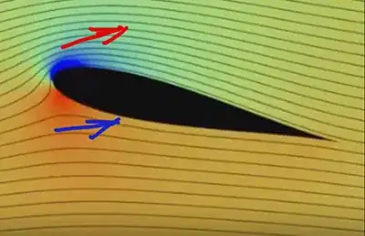

Wings provide lift because they direct air downwards.
They direct air downwards in two ways. In part, the bottom of the wing slopes downward a bit and just pushes the air down as it moves forward through the air. But this is a small effect. The top of the wing is more important.
The top of the wing pulls the air down partially by providing a ramp. The rear portion of the top of the wing slopes down to a sharp trailing edge. The air, which is under pressure from the miles of air above it, follows that slope down the wing, and continues downward after the wing has passed.
But there is more to it than that. As the wing drives forward, the air that is deflected upward by the leading edge ends up being pinched between the layers of air above and the bulging top of the wing. That pinching makes the air speed up, not so differently from the way pinching a wet watermelon seed can send it flying. The inertia of the air that is farther from the wing forces the air that is closer to the wing to hug the wing's top surface, reaching the trailing edge much sooner than the corresponding molecules that headed along the bottom.
The asymmetry, of course, is key here. The bottom of the wing is more nearly parallel to the path of the air, with a bit of a downward slope all the way to the back, so it doesn't have the same pinching effect. (The asymmetry doesn't have to be in the shape of the wing. It can all be in the angle of attack. You are still creating a scenario where the air is pinched more on one side than the other.)
Of course there is no clear boundary between the layers of air that are doing the pinching and the air that is being pinched. But still, the force of the wing is felt most strongly by the air that is closest, and so that layer is accelerated the most. Each bit of air pinches the air below and is pinched against the air above, to a decreasing degree, until the effect is no longer noticeable quite some distance above the wing.
All this accelerated air is subject to the Bernoulli effect. Because it has been accelerated, its downward pressure on the wing is less than the upward pressure of the air below, and also the upward pressure on the air above is less than the ambient pressure. This causes even more air to move downward than otherwise would do so. Unless I am mistaken this is an important part of the downward deflection of the air.
The myth, then, is not that the Bernoulli effect is important. The myth is that there is an equal-time principle that is the reason the air atop the wing moves faster.
But the explanation is still incomplete because the Bernoulli principle itself is not obvious. The principle is often explained in terms of the low pressure causing the acceleration -- if you create an area of low pressure, air will indeed accelerate towards it. But if you blow into a tube with a construction, the decrease in pressure at the constriction will try to constrict it more. The upstream pressure from your lungs really is causing the decrease in pressure; it is not just the lower pressure that is causing the air to flow.
The way that increased pressure in your lungs can cause decreased pressure at the constriction is that your lungs give the air momentum. When the air finally leaves the tube that momentum is absorbed by the surrounding air, pushing it back like a mob pushing into a standing crowd. That momentum keeps some of the back pressure from being felt by the moving air in the tube. The higher the speed, the less momentum density, and the less back pressure.
In fact, in a steady state, inviscid, incompressible model, the question of what causes what becomes almost meaningless. The air speeds up because there is lower pressure in front, and there is lower pressure in front because of the velocity of the air. But in the case of an airplane, my understanding is that that the thrust of the engines is causing the acceleration of the air by more than just letting the downward sloping top of the wing recede from it. Even at high subsonic speeds where the air can no longer be treated as incompressible, the qualitative phenomenon that greater velocity leads to reduced pressure still applies. Calculating the effect just becomes more complicated.
Frequently, Bernoulli's principle is derived using conservation of energy along streamlines. I think my qualitative explanation using momentum is consistent with that.
The principle of lift is often explained using circulation. Again, I think that is just a different way of describing the same process. The different velocities along the top and the bottom constitute a net circulation.
Note: See "Why does the air flow faster over the top of an airfoil?" for additional answers to that part of the question of lift.

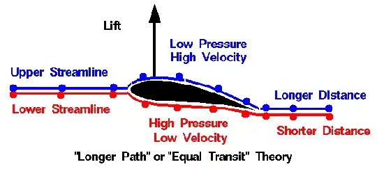

Without going into the excellent and detailed mechanics explaining reaction lift that others have provided for this answer, I just want to say that contrary to popular belief/high school physics textbooks, airplanes do not fly solely on account of Bernoulli's principle. According to Walter Lewin's excellent "For the Love of Physics":
"Bernoulli's principle accounts for 20% of an airplane's lift, the rest is provided by reaction lift."
Walter Lewin also poses an insightful question if planes really fly due to the equal transit theory and Bernoulli's principle (they do not!). enter image description here
"...then how do planes fly upside down?"

Consider the velocity field of the particles in the air mass in a 2D projection of the X(forward) and Z(up) axes. For each particle, Integrate over area and time, to derive the center of air-mass momentum (p) before and after the passage of the airplane : dp/dt. (On a very calm morning, with no wind or turbulence, the center of air-mass and its momentum is stationary in Z(assume level un-accelerated flight), and equal to the True Airspeed in X pointing in the aft -X direction. Integrate over the area and you will find that the center and momentum of the particle and vector field has changed, with passage of the plane. This center of air mass and center of momentum will move forward(+X) and downward(-Z) relative to its original state. The equal and opposite momentum change with time dp/dt of the airplane is a force. We might label the -X component "drag" and the +Z component "lift"(careful: the airplane coordinate system is different from the stationary airmass). This is a dissipative system, so don't wait too long after the plane passes to record the vector field. We can observe this process in contrails on clear days when the high altitude air is cold and relatively moist. Sadly since we mostly view them from below with a projection along the Z, we miss the downward component of the momentum field. You can see this as a test pilot, flying as chase wing-man, in formation (projection in the Y-Z plane from behind or X-Z from the side). Expand this model to 3D to include lateral or Y axis flow and effects! I suggest this "p-dot"(dp/dt) of momentum-change explanation is better, than "pushing" or "pulling" the air downwards, because the later may confuse position and momentum in the view of the reader. This is also the first term(LHS) in the beautiful Euler-LaGrange equation, which would lead to an even more elegant analysis of this question!
As a new user, I will need to figure out how to attach the appropriate Figures and Equations to this post...-thanks
Note: The drag equation is really the ideal gas law, except density replaces m/V.
P/rho = R T :
Initially air moving over the top of the wing but not touching the wing, because it is sticky (viscous), pulls air between itself and the wing top away creating a low pressure zone on top of the wing. The slope on top of the wing makes it possible to create this low pressure zone. When air strikes the front of the wing it is compressed and then expands into the low pressure zone with increased speed but lower pressure than the pressure in the atmosphere. On the bottom of the wing most of the lift arises because of the angle a wing it tilted at ( angle of attack ) .This angle causes downwards deflection of air and because of Newtons Law (action reaction) the wing is pushed upwards.
Fluid interactions with solid bodies depend on the fluid properties and the geometry of the object. In the case of an aeroplane, we have air as our fluid and an aerofoil geometry. The aerofoil geometry is designed on purpose to force fluid under it preferentially to above it. This results in a pressure difference, which then leads to a buoyancy force that accelerates the wing according to Newton's second law (lift). Bernoulli's law is relevant for calculating the fluid problem.
So, to achieve flight, all you need is some well-designed aerofoils and some way of imparting an initial velocity. To keep flying you need to keep your speed high and to keep flying stably you need a well-designed aircraft with the centre of mass, centre of thrust and centre of lift being in the same position.
Because of the obstruction of the wing, the air has to go around the wing, so the air pressure at the bottom of the wing is increased because the air at the bottom of the wing is compressed to go around the wing, and the air at the top of the wing is stretched around the wing, so the air pressure at the top of the wing decreases. So there's a pressure difference, and then there's a lift.
Note: The bottom of the wing is windward, so the air is compressed, the pressure is high, and the top of the wing is leeward, so the air is stretched and the pressure is low.
So lift cannot be explained by Bernoulli's theorem. Because Bernoulli's theorem does not consider the compression and stretching of fluid.
The following is a detailed explanation:
On the upper surface of the wing, the direction of the air velocity at point A is the direction of the blue arrow, which has an angle of less than ninety degrees with the normal direction of the upper surface of the wing (note the angle between the blue arrow and the normal of point A in the figure). Therefore, the air at point A tends to move away from the wing surface along the normal direction, so the air at point A is stretched, and the air pressure at point A decreases. The direction of the air velocity at point B is the direction of the red arrow, which has an angle of less than ninety degrees with the normal direction of the upper surface of the wing (note the angle between the red arrow and the normal of point B in the figure). Therefore, the air at point B tends to move away from the wing surface along the normal direction, so the air at point B is stretched, and the air pressure at point B decreases. Low pressure is generated at almost every point on the upper surface of the wing, which in turn generates lift on the upper surface of the wing.
![enter image description here
On the wing surface, the angle between the air velocity direction and the normal direction is greater than 90 degrees, so the air is compressed, so the pressure increases, which also causes the lift on the lower surface of the wing. For example, the angle between the air velocity direction at points C and D and the normal direction at points C and D is less than 90 degrees.
enbin
  • 2,306
If there is no low pressure (negative pressure) at the top of the wing, will the airflow move downward? Obviously it won't move down. Wing lift comes from the low pressure at the top of the wing and the high pressure at the bottom of the wing. The downward movement of airflow is only the result of high and low pressure. Why is the top of the wing low pressure? Because the airflow tends to leave along the normal direction of the wing. Why is the bottom of the wing high? Because the airflow tends to approach along the normal direction of the wing.
