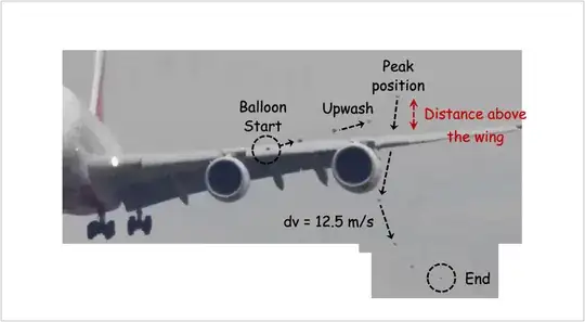

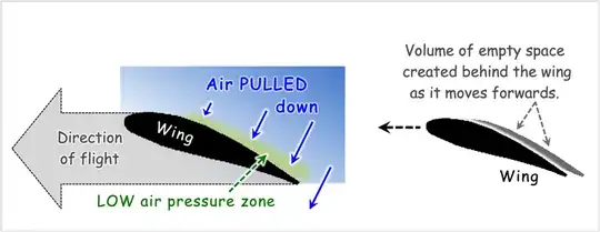

As the wing moves forwards, it creates void of empty space behind it, on the topside of the wing. This is a low-pressure zone, which then pulls the air above the wing downwards.
wing airflows
To see the full explanation search for ‘Newton explains lift’ on www.researchgate.net
The airflows created by the topside of the wing can be observed from a balloon that was seen to cross in front an A-380 airliner on approach to landing.
balloon
The video is on youtube: Airbus A380 vs Balloon; YouTube channel: 3 Minutes of Aviation; Mar 8, 2023; https://youtu.be/ir06S6ntbyk
