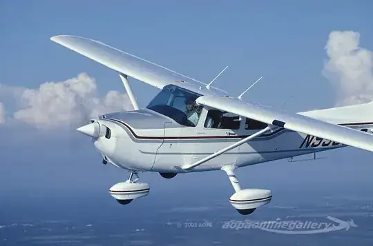

Here's one of my favorite pictures, of a Cessna 172 Skyhawk. It's the same model I fly. I'd like to draw your attention to a few things about it.
  • Notice the pilot (in the white shirt) is looking right at the camera. That's because he's flying in formation with the photographer's airplane, and he really doesn't want to get too close. It's a long way down.
  • The airplane is not level. It is banked toward the photographer. That means it is turning left because its lift vector is not vertical, exactly as in a bicycle or motorcycle. (It also means the photographer's plane is in a left turn, so they stay in formation.)
  • The air is flowing past the airplane at somewhere around 100 miles per hour. Even though the plane is nicely streamlined, the air makes a pretty loud hissing sound.
  • Notice the propeller, it is being cranked at around 30 revolutions per second. It is creating a forward pull of around 200 lbs, which is overcoming the drag of that 100 mph hurricane blowing past the entire structure.
  • Notice the shape of the wings. They are more curved on top, of course, but you can also see that they work to deflect that wind downward. If you could see the wind, you would see that it forms a wake, just like the wake of a planing speedboat. It takes a lot of downward force to deflect the air down into that wake. In fact, the downward force is just the weight of the plane. It is surfing, plain and simple.
  • What you can't see is the weight of the engine up front. In fact, if it weren't for the tail pushing down and holding the nose up, the plane would just drop straight to the ground. The reason for that is, if it slows down the nose drops, causing it to speed up, causing the nose to rise, causing it to slow down, etc. It's for stability. The speed controls itself. To set the speed, you turn a little wheel that applies some forward or backward pressure on the stick.
  • Notice the sides of the airplane. They are broad and flat. This, with the vertical stabilizer, keeps the plane pointed into the wind, like a weathervane. If you're having trouble getting down and need more drag, you can push one of the rudder pedals. That causes the plane to get a bit sideways to the wind, so the wind drags a lot on the side of the plane. If you're sitting in the seat, you feel a strong sideways force, just like a car skidding.
  • Notice the wing is not straight. It bends up on the left and right (called dihedral). That's another stability feature. If something causes the plane to get a little crosswise to the wind, one of the wings will project forward. Because of its dihedral angle, the wind will get "under it" more than the other one, and lift it. That causes the plane to bank, which causes it to start turning, so it is no longer crossways to the wind. (The Spirit of St. Louis had no dihedral, and a small tail. It kept Lindbergh awake for a day and a half using the rudder just trying to keep it straight.)
  • Notice the wheels. There are two on the sides, and the one in the front can steer. The two side wheels are set back of the center of gravity so when it is on the ground it doesn't fall over backward. This is better than the old style, where the third wheel was at the back and the side wheels were set forward. The reason was, with the old style if the plane got the least bit sideways on the runway while landing, it could have a vicious tendency to turn even more sideways, or "ground loop", badly damaging the plane and possibly killing the occupants. Pilots of "tail-draggers" are skilled at preventing this.
