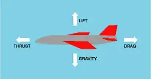

There are essentially four forces on an airplane.
There is a lift force from the wings - this force points upwards. There is a force of Gravity, which points downwards. There is a force of thrust from the engines pointing forwards, and a force of drag pointing backwards.
If you're visualizing these four forces, then you should see that the drag force opposes the thrust force, and the lift force opposes the force of gravity.
So, if you have a more massive plane, then the force of gravity is greater. That means to maintain a constant altitude, you need a larger lift force. The amount of lift you get is positively related to your speed, and the faster you go, the greater the drag force, which means you need more thrust, and that takes more fuel.
