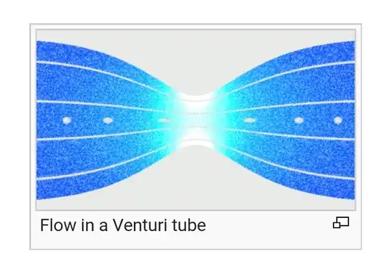

The part I don't follow is that the picture below shows an obvious constriction, whereas a crack in say, the constant diameter rear exhaust box/muffler, is just a crack, not a narrowing.
Anyway, the venturi effect makes sense to me in terms of air molecules movement.
As they enter the narrow part, the air molecules must speed up to maintain continuity of flow. So instead of exerting pressure randomly in all directions, now a lot of them are forced in the direction along the long axis of the exhaust, so less are available to "point" upwards, so static pressure drops and the outside air flows in.
The theoretical pressure drop at the constriction is given by this formula below, which is based on Bernoulli's equation:
$${\displaystyle p_{1}-p_{2}={\frac {\rho }{2}}\left(v_{2}^{2}-v_{1}^{2}\right)}$$
where ${\displaystyle \scriptstyle \rho \,}$ is the density of the fluid, ${\displaystyle \scriptstyle v_{1}}$ is the (slower) fluid velocity where the pipe is wider, ${\displaystyle \scriptstyle v_{2}}$ is the (faster) fluid velocity where the pipe is narrowed.
