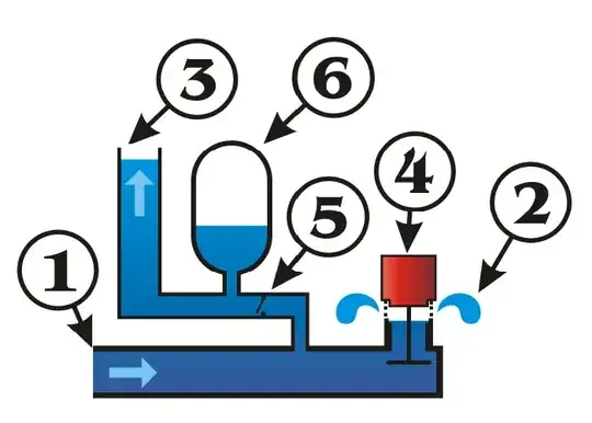

It could be due to similar principles behind a hydraulic ram, where water is taken at high flowrate, low head and ejected at lower flowrate and higher head.
There needs to be a kink upstream to trap air and form a closed pressure vessel, which is possible as water level rises during heavy rainfalls.
Here the sewer cover would act as the relief labled no. 4.
Hydraulic ram schematic from Wikipedia
