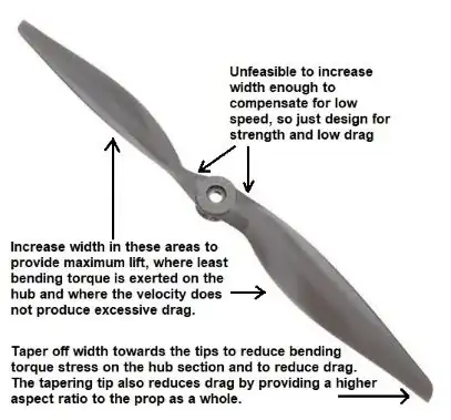

A horizontal aircraft propeller is very similar in principle to a helicopter blade and aircraft propellers generally have wider sections nearest the base, except for the sections right next to the hub that are so slow, relatively speaking, that they are generally just shaped for strength and low drag, rather than shaped for lift or thrust. The aircraft propeller starts out narrow (because the lift very near the hub is just a waste of time, gradually increases to a maximum width where the lift is useful and then tapers off again towards the tips, where excess width just causes excessive bending torque.

Consider a blade of radius D that is wider at the tips. A section at the tip might provide X amount of lift. This amount of lift creates a bending torque of X*D on the blade. If instead we put the wide section of the blade nearest the hub, say at 0.01 D, then the bending torque on the blade for the same amount of lift is 0.01 X D and so the blade can be made lighter as it has to resist less bending torque.
Another factor to be taken into account is drag. One form of drag is skin friction drag and this is proportional to the cross sectional width and velocity squared. Have too large a cross sectional width near the tips where the velocity is highest increases the overall drag.
From the above it might seem that short fat stubby blades would be ideal, but there is another form of drag called lift induced drag and this is inversely proportional to the aspect ratio and favours long thin wing and blade profiles for low drag. Helicopter rotors generally have a larger radius than propellers and this is because the hover efficiency is better for a low disk loading that results from having a greater radius.

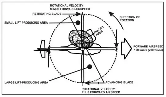

An examination of the image above reveals another reason helicopter rotors require a larger radius than a propeller. During forward flight the part nearest the hub on the retreating side fails to produce lift and it it was not for the part of the rotor outside the shaded area, the helicopter would have no lift on one side and be unable to fly normally. A smaller diameter rotor would limit the maximum forward motion of the helicopter.
