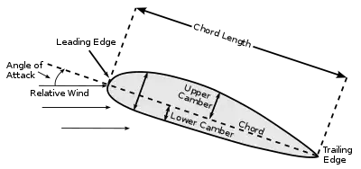

To start with, I think we need to identify the point at which the flow separates. Looking at Wikipedia, I'll post two images:
airfoil
The argument that the wind flows faster over the top is mostly a consequence of geometry. First identify the point at which the flow separates, meaning the point above which the fluid goes over and below which the fluid goes under, this is slightly below the front-most point of the airfoil, due to the fact that it's angled slightly upward. If both paths take roughly the same time to pass over the wing, then the average velocity of the fluid from the point of separation to the tail where the flow rejoins will be roughly proportional to the distance from those two points.
Now, you may say, "but it will flow faster over the top even if the top isn't curved more!" You would be correct. A plane can function with no additional curve on the top of the wing, as the famous xkcd comic points out. Such a mode of flying, however, will still see the fluid passing over the top of the wing faster. A simple argument for this is that the point of separation is lower than the front of the wing, again, since the wing is angled up. A plane can fly upside down, but I don't know of a plane that can maintain altitude with the wings not angled up. The curved top, however, increases efficiency by intensifying that natural effect.
I hope that helps some, this is intentionally not a rigorous answer, and I want to recognize that I am not addressing the more hairy details of the actual fluid equations associated with this, which are required for a full explanation. In short, the fluid velocity over a surface isn't completely proportional to the distance traveled. Even without getting into that, however, I think your question is mostly answered.

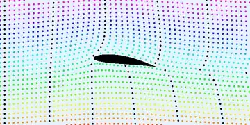

I realize that my answer up to this point may not only be incomplete, but might not answer the question. The question is why the flow on the top is moving faster than on the bottom. Let me post another image.
Wiki gif
There are 2 things I want to note here.
  1. The fluid above the wing does speed up and the fluid below the wing does slow down. I just want to confirm this is still the case.
  2. The fluid going above and below does not have the same travel time over the wing.
Number 2 is particularly important because it is simply not correct to say that the speed is proportional to the distance between the separation and rejoin point. That way of looking at it may still have some usefulness. But I digress.
At this point I'm repeating Wikipedia's explanation, but refer to the 2nd image in this answer. Under some assumptions the fluid does not cross the blue streamlines. That means that when the channel size between 2 blue streamlines narrows or widens, the fluid speed changes correspondingly. I'm still hand waving away plenty of technical detail, but please let me offer this as basic level answer.
The fluid on top of the wing is accelerated and the fluid on the bottom of the wind is slowed down compared to velocity of the aircraft itself because the wing geometry and angle narrows the flow area above the wing and widens the flow area below the wing
This is the absolute best explanation I have. If you assume that the fluid is incompressible it works great, if not, it works less great but still works. There are also some other assumptions, I hope that the general point is still the same with all those included. The bold text is the best answer I have and I think it's a good one.

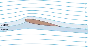

Here's a picture showing the airflow around a wing.
One might easily form an impression that the lift in the wing is produced by the air deflecting off the bottom of it. It is true that there can be some lift owing to this, however, most of the lift is generated due to the action on the top of the wing.
Imagine that the streamline $A$ in the above figure just grazes the highest point on the top of the wing. If this streamline was not acted upon by any external force, it would just go straight tangentially to that point and not follow the wing. This would result in a vacuum of sorts between the streamline and the wing. Thus the streamline would be pushed down to follow the surface of the wing due to the difference in pressure above and below it, and would also accelerate during the course. The streamline $B$ which lies just above $A$ would similarly bend to follow $A$, and so on.
The pressure on the top of the wing is lower than the ambient pressure, and this is the main basis for the generation of lift.
Also note that this decrement in air pressure (with respect to the ambient pressure) above the top of the wing decreases with increasing distance from the wing.
Here's a simulation showing the difference in speed of streamlines above and below the wing. Unlike common misconception, the streamlines which separate at the tip of the wing do not meet at the tail of the wing.
