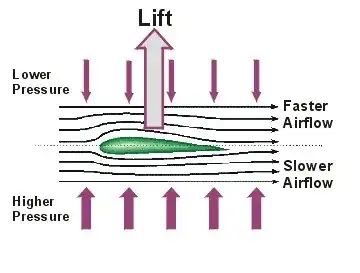

Correct me if I'm wrong, I think the pressure in a fluid reduces when the speed increases(The airplane rises because the air above the airfoil moves faster than the air below it).

That explanation of aerodynamic lift is a common misconception
First, to correct a misconception:
This statement is a common misconception supported even by some authoritative sources. However the logic behind it presumes that equilibrium behavior applies in dynamic scenarios which doesn't hold; more in the comments below.
"What really allows airplanes to fly?" has some excellent discussion on airfoils.

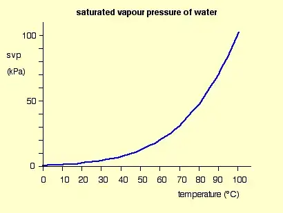

If a liquid is starting to boil I'd usually apply that to the whole liquid not just a part of it.
If you just make a part of it evaporate due to extremely low pressure in one part that does not make the whole liquid boil.
Here is a link saturated vapour pressure
There is plot in this link and I attached here.
So if we want the water to boil, we need bring either pressure or temperature to the curve. I think the above discussion is assuming the temperature is room temperature e.g. 20-25 degrees C. So the focus is how to bring the pressure down by fast stirring. This is also the reasoning in the question. I think making your stirring spoon having a shape of airfoil can reduce local pressure down to the vapor pressure if you spin fast. You will get local evaporation (cold though).
It could be thought in another way, fast stirring can increase the temperature to 100 degrees and thus boil the water. The stirring does not to be necessary in one direction. The goal is to let the work dissipated to heat by viscosity.
