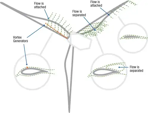

This is how a vortex generator delays flow seperation, as others have already pointed out. Cars also use vortex generators to channel the flow before either breaking it out with a spoiler or generating downforce using a wing, as in the case of F1 cars.
Vortex Generators on a wind turbine
Image Source: https://en.wikipedia.org/wiki/Vortex_generator
