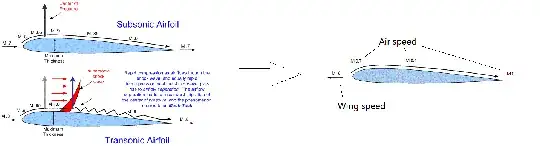

so,the title could be a bit misleading, let me elaborate: whenever studying aerodynamics, the explanation starts with considering the wing of a plane still, and the flow of air arriving from either left or right at the speed at which the wing itself is flying; now, because of Bernoulli principle, the flow of air sliding on the upper surface of the wing will accelerate, sometimes past the speed of sound in the air, generating a shockwave. BUT creating a model in which the wing is stationary and the wind coming, say, from left to right, means also that in the real world we have to invert all the velocities in the model, and in this case, in no point will the air go supersonic, but rather it will be dragged for a bit by the trailing edge before slowing down over the wing.
The closest example I can think of is pushing a hand on the surface of the sea: the water in front of the hand gets accelerated at the same speed of the hand, goes over it, slows down, goes back to stationary. In no point goes the water FASTER than the hand, and surely not in the direction opposite to the direction of the hand.
Are these considerations correct? If so, how do shockwave actually form? I hope the picture gives a bit more clarity.

I do not follow this at all. The transformation is a simple Galilean transformation, i.e., the Mach number will not change because there is only one frame of reference in which it is physically meaningful. That frame is the frame of the piston/driver. Here that would be the airfoil rest frame. Sure, you can calculate the Mach number in different reference frames but the value is always defined with respect to the piston/driver so you will just have some additional work in subtracting velocities to get the proper normally incident flow (e.g., see answer here about aberration https://physics.stackexchange.com/a/669965/59023).

To better understand the local shockwaves on a transsonic wing (the example shown in your question), imagine how the air needs to make space for the volume of the airplane passing by: Somehow this air needs to momentarily occupy a smaller volume. It does so by flowing faster, which (according to Bernoulli) reduces local pressure. This pressure sucks in the oncoming air, accelerating it so the process continues. For a more detailed explanation, please read this answer.
