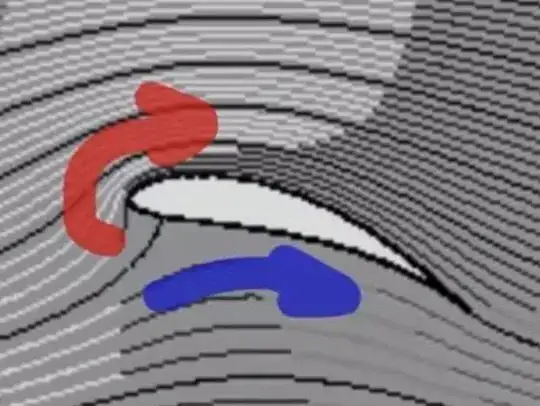

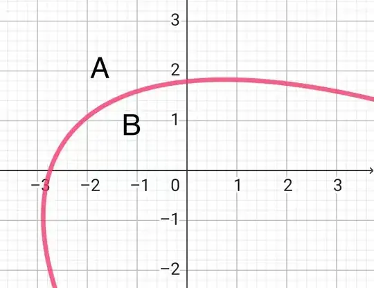

enter image description here As shown in the figure, we define that one side of the object at the curvature center of the curve is within the curve, such as A in the figure; The object on the other side of the curve is outside the curve, such as B in the figure. enter image description here As shown in the figure, the red curve represents the curve of the airflow around the wing from the top of the wing, and the wing and the curvature center of the curve are on the same side. Due to centrifugal force, the air flow tends to be far away from the upper surface of the wing, so the pressure on the upper surface of the wing decreases. The blue curve represents the curve of the airflow around the wing from the bottom of the wing, and the curvature center of the wing and the curve is not on the same side. Due to centrifugal force, the air flow tends to compress the lower surface of the wing, so the pressure on the lower surface of the wing increases. In this way, the pressure difference between the top and bottom of the wing also leads to the lift of the wing. The lift of insects' wings is also generated according to this principle. Because the air flow will also circle the wings along the curve, it will also generate centrifugal force and lift force. This is nothing special. So lift is not explained by Bernoulli's theorem.
