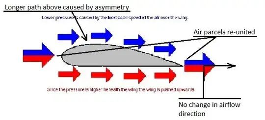

EDIT: It is easy to find wrong pictures like this: enter image description here
as opposed to a correct one like this (from the link above):
So the answer to your question is: All of the lift depends on the Bernoulli principle, because speed and pressure are in trade-off, but the physics need to be correctly understood.

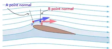

Because of the obstruction of the wing, the air has to go around the wing, so the air pressure at the bottom of the wing is increased because the air at the bottom of the wing is compressed to go around the wing, and the air at the top of the wing is stretched around the wing, so the air pressure at the top of the wing decreases. So there's a pressure difference, and then there's a lift.
Note: The bottom of the wing is windward, so the air is compressed, the pressure is high, and the top of the wing is leeward, so the air is stretched and the pressure is low.
So lift cannot be explained by Bernoulli's theorem. Because Bernoulli's theorem does not consider the compression and stretching of fluid.
The following is a detailed explanation:
For example, at the top of the wing, the direction of air velocity at point A is the direction of the blue arrow. Because the blue arrow is inclined (note the angle between the blue arrow and the blue normal in the picture), the blue arrow tends to be far away from the wing along the normal direction at the top of the wing, so the air pressure at the top of the wing is stretched, so the air pressure at the top of the wing decreases, so there is a pressure difference (pressure gradient). This pressure difference changes the direction of air velocity, so the direction of air velocity at point B is the direction of the red arrow, and the red arrow is also inclined.... So the direction of air velocity will continue to change along the top of the wing.
It should be noted that this pressure difference not only changes the velocity direction of the air on the top of the wing, but also generates the lift of the wing.
Due to the low pressure generated by stretching and the high pressure generated by compression, the lift of an aircraft cannot be explained by the Bernoulli principle, which is based on the incompressibility of fluids. So, in this sense, we can say that Bernoulli's principle does not contribute to wing lift.
Of course, we can assume that the fluid is incompressible and perform calculations, but this is not the actual situation of lift.
