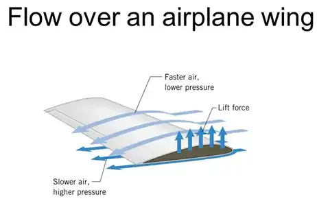

  • An airplane wing creates a faster air flow on the upper side and slower air flow on the lower side.
  • Pressure of a gas and the speed of the gas molecules are directly related. If the speed of molecules increases, pressure will also increase.
Are these assumptions correct? If not can you correct it? If they are not wrong: can you please help me understand how an higher speed of air flow creates a lower air pressure? A higher speed of airflow does not mean a higher average molecule speed as well?

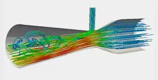

This may sound all very hand-waving, and it is, but this is precisely how modern aerodynamics is actually calculated. What you do is make a huge 3D matrix in memory, and fill it with a number representing the velocity of that little cell of air. So for instance, in our case we might fill it with 50,0,0, meaning the air is moving 50 m/s to the right (which is easier than moving the plane 50m/s to the left).
Now you say that any cell that touches the object reflects from it. And then in the next iteration that cell bumps into the cell beside it, and so on. And you keep iterating until you (hopefully) get a steady state. Like this:
You can see all of the effects we're talking about in that image. You can see how the air goes down the intake it gets squeezed, and that sort of squeezes it into the restriction. Then it passes the restriction and spreads out again.
This is an example of "do it on the computer" that really works; instead of using mass flow formulas and stuff you just stick the object in the computer and you'll know what really happens.
