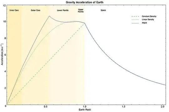

The other answers provide a first-order approximation, assuming uniform density (though Adam Zalcman's does allude to deviations from linearity). (Summary: All the mass farther away from the center cancels out, and gravity decreases linearly with depth from 1 g at the surface to zero at the center.)
But in fact, the Earth's core is substantially more dense than the outer layers (mantle and crust), and gravity actually increases a bit as you descend, reaching a maximum at the boundary between the outer core and the lower mantle. Within the core, it rapidly drops to zero as you approach the center, where the planet's entire mass is exerting a gravitational pull from all directions.
The Wikipedia article on "gravity of Earth" goes into the details, including this graph:
Gravitational acceleration vs. depth
"PREM" in the figure refers to the Preliminary Reference Earth Model.
Larger versions of the graph can be seen here
And there are other, smaller, effects as well. The Earth's rotation results in a smaller effective gravity near the equator, the equatorial bulge that results from that rotation also has a small effect, and mass concentrations have local effects.

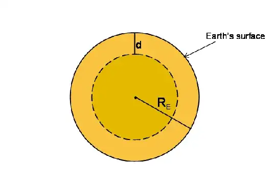

Acceleration due to gravity at depth d below the earth's surface is given by:
$g(d) = G M_e \dfrac{R_e - d}{R_e^3}$
Where,
G = Universal gravitational constant
Me = Mass of the earth
Re = Radius of the earth
d = depth below the earth's surface
