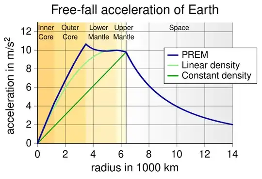

Gravitation inside the Earth
One thing pops right out from the physics-based derivation: Gravitational acceleration increases with increasing depth if the local density $\rho(z)$ is less than 2/3 times the mean density $\bar \rho(r)$ of all the stuff at a depth $z$ or greater. It decreases if the local density is at least 2/3 of the mean density. Surface rock has a density a bit less than 1/2 the mean density of the Earth, so gravitational acceleration initially increases with increasing depth. In fact, gravitational acceleration inside the Earth is above the surface value until just below the core-mantle boundary. The global maximum occurs at the core-mantle boundary. The Earth's core is very, very dense stuff. It's mostly iron and it is highly compressed.
This is exactly what is seen in the Preliminary Reference Earth Model. Below are some links to the PREM.
Wikipedia article: http://en.wikipedia.org/wiki/Preliminary_reference_Earth_model
Model parameters: http://geophysics.ou.edu/solid_earth/prem.html
Paper: Dziewonski, A. M., & Anderson, D. L. (1981). "Preliminary reference Earth model." Physics of the earth and planetary interiors, 25(4), 297-356.
Finally, here's a graph of gravitational acceleration above and inside the Earth.
Image source: http://en.wikipedia.org/wiki/File:EarthGravityPREM.svg
