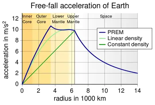

The earth is not a uniform sphere though. The outer crust is much less dense than the iron core. Approaching this core then allows gravity to increase with depth for a distance before finally decreasing.
The Gravity of Earth wiki page has a graph based on a reference model of the density of the earth with depth.
Earth gravity with depth
Under that model, gravity at half the earth's radius is just about equal to that at the surface.
