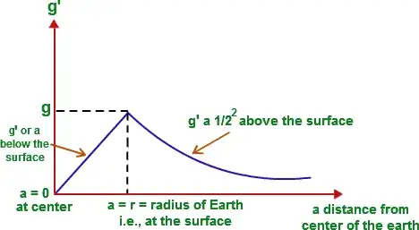

Distance correction :
The following formula approximates the Earth's gravity variation with altitude:
$$g_h=g_0\left(\frac{R_e}{R_e+h}\right)^2$$
Where
$g_h$ is the gravitational acceleration at height h above sea level.
$R_e$ is the Earth's mean radius.
$g_0$ is the standard gravitational acceleration.
Variation with depth:
$$g_{eff}=g\left(1-\frac{d}{R}\right)$$
These formulas clear the other question of OP.
