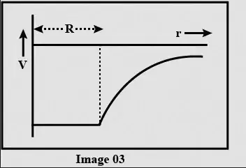

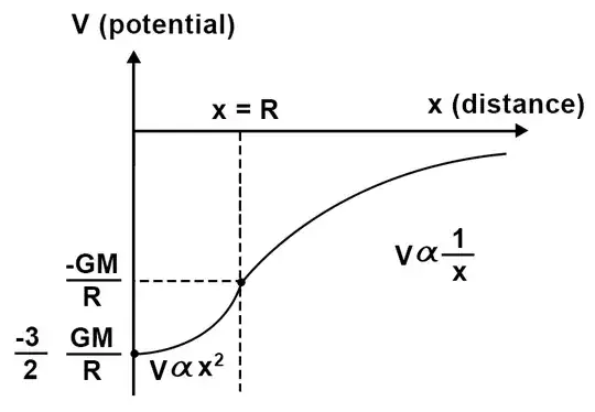

Graphs of the gravitational potential
Graphically the potential of a hollow sphere looks like this:
For a solid sphere it is:
