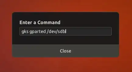

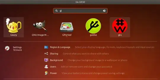

Logout/login or reboot, and there should be a working desktop icon. It will work from a terminal window like with the simple solution with the function.
Alt F2 box:
Gnome Shell menu:

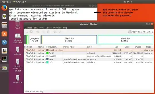

gks console and gparted:
