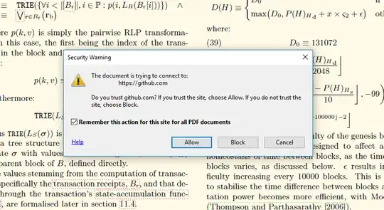

When I click the link in Adobe Acrobat Reader on Windows 10, I get this prompt:
PDF link permission prompt
Clicking allow then opens the URL in the default browser. So I can confirm that this is an issue with Ubuntu.
