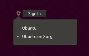

The most, if not all current remote desktop tools wont work with Wayland, to mitigate this I'd suggest switching back to Xorg. You can do that by simply logging out and when logging back in clicking that small cogwheel icon and choose 'Ubuntu on Xorg' (see screen-shot).
