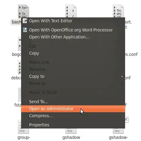

For Ubuntu <= 10.10 , 10.04
nautilus-gksu Install nautilus-gksu
Is an extension that grants root privileges using gksu nautilus.
It enables an option when you right-click on a file (also directories and other...) in nautilus: "Open as administrator". After installing it restart Nautilus (killall nautilus) and it will have the new feature.

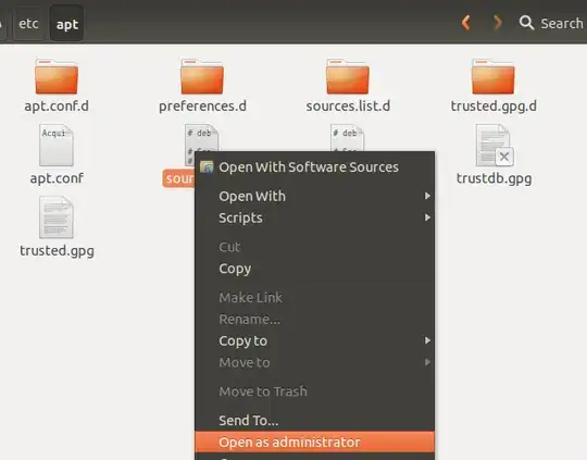

Ubuntu 12.04 and later
Nautilus Admin (nautilus-admin) is a simple Python extension for the Nautilus file manager that adds some administrative actions to the right-click menu:
  • Open as Administrator: opens a folder in a new Nautilus window running with administrator (root) privileges.
  • Edit as Administrator: opens a file in a Gedit window running with administrator (root) privileges.
To install Nautilus Admin in all currently supported versions of Ubuntu open the terminal and type:
sudo apt install nautilus-admin
gksu is discontinued in the official 18.04 and later repositories.
Alternatively open the directory in nautilus as root from the terminal with a command of the form:
sudo -H nautilus /path/to/directory
