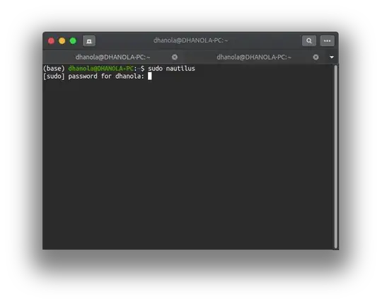

I am using Ubuntu 20.04 focal. I have been wanting the GUI password prompt for executing command with sudo in terminal.Example consider following command to be runned by terminal :
sudo nautilus

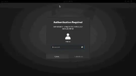

So now, it will ask for the sudo password by GUI prompt otherwise it will not run as sudo:
GUI password promp
