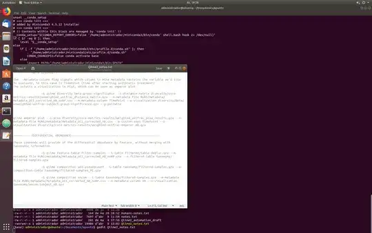

I try to open it with gedit:
gedit Qiime2_notes.txt
and it opens the file without any error warning, but I can't write, select or save the text.
Basically as if I hadn't got any permission to modify the text:
ss

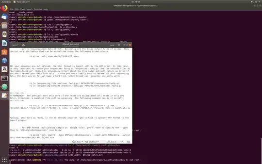

however, when I open it with sudo gedit Qiime2_notes.txt, it works perfectly.
Now I can perfectly modify the file:
ss
