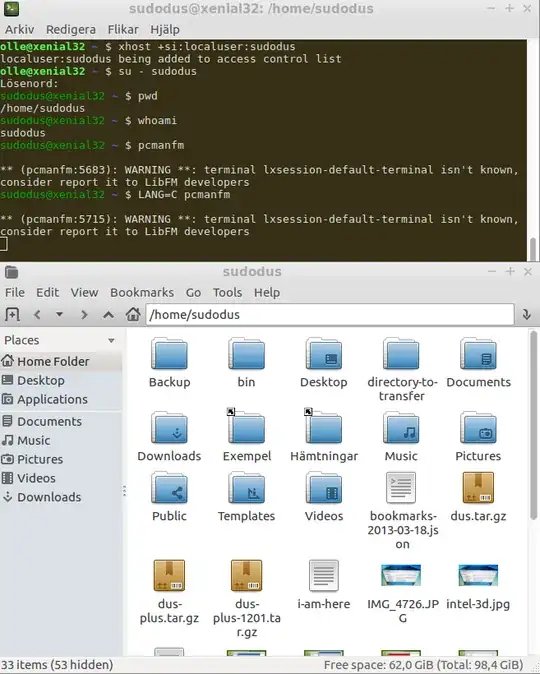

  • Next you can start your file browser or some other graphical program. I'm running Lubuntu, so I start pcmanfm. In standard Ubuntu you would run
    nautilus --no-desktop
The following screenshot illustrates how it works.
LANG=C pcmanfm makes pcmanfm use the default language, US English, instead of my local language.
