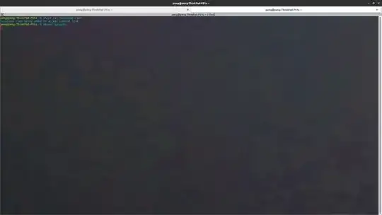

After the OS is running for a while, it may trigger for a bug that caused pkexec (including any application that use it, including synaptic) to hang. This can only be recovered from relaunching OS or gnome-shell.
This is a screenshot that describe this situation:
xhost +si:localuser:root
pkexec synaptic
I remember the same error in Manjaro with gnome 3.28, it disappeared in gnome 3.30. How do I backport the fix (if there is any) to Ubuntu 18.04?
