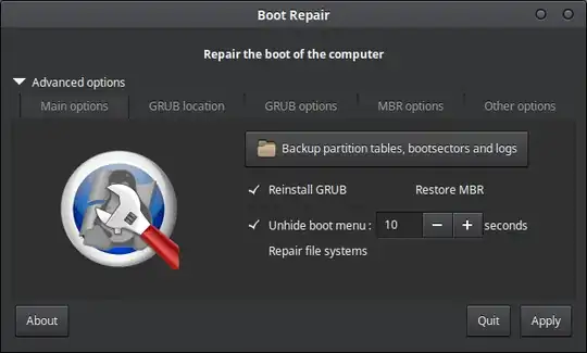

Open the Boot Repair application and select Advanced Options -> Main Options tab -> check Reinstall GRUB and Unhide boot menu as shown in the below screenshot. Click the Apply button. Then reboot the computer with sudo reboot

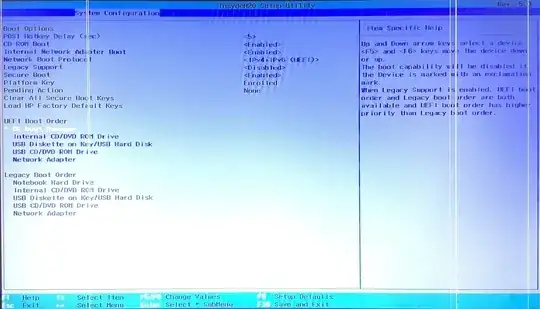

If the OSs were installed in different modes, dual booting Windows and Ubuntu with grub can't work. If your Windows is installed in BIOS mode, it is recommended to install your Ubuntu in BIOS mode, but if it's installed in UEFI mode, then do the same with Ubuntu. To check if your Windows is installed in UEFI, press the keyboard combination Windows (IMG: ) + r then enter the command msinfo32 in the Run window. In the new window that opens up look for the entry after where it says BIOS Mode.
          BIOS vs. UEFI
If you have installed Ubuntu in legacy mode on the same drive with GPT partitioning, you can use Boot Repair's Advanced options to uninstall grub-pc and install grub-efi-amd64. That converts the Ubuntu installation from BIOS boot to UEFI boot, the same firmware as most recently manufactured laptops with Windows pre-installed have.

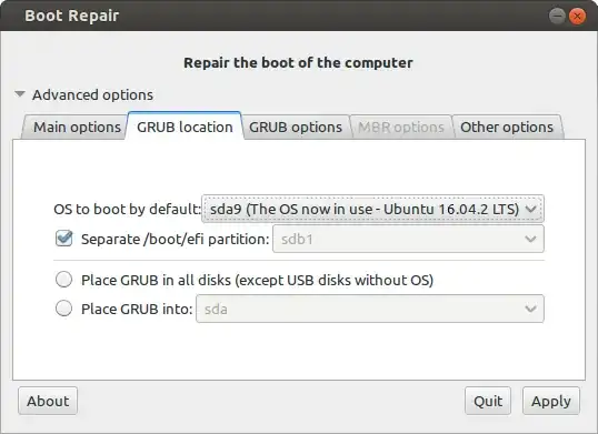

Converting Ubuntu into UEFI mode
  1. Start Boot-Repair, and select Advanced options -> GRUB location tab.
  2. If you do not see a Separate /boot/efi partition option, this means that your PC does not have any UEFI partition.
  3. If you see a Separate /boot/efi partition option, put a checkmark in the checkbox to the left of it, then click the Apply button in the lower right corner.

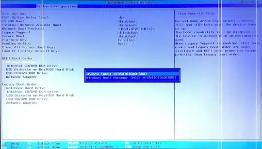

What worked for me is selecting OS boot manager in the BIOS boot Options menu and pressing Enter.
Boot Options menu in BIOS:
A popup should appear asking whether you want Windows or Ubuntu boot manager. Use F5/F6 to move Ubuntu to the top.
After clicking enter after selecting OS boot manager:
Then exit BIOS by saving settings. It should boot into GRUB after that. Unfortunately none of these other answers worked for me.

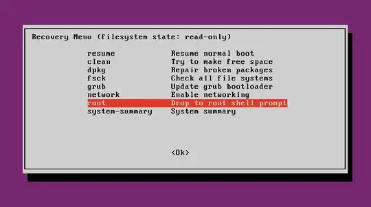

I had a similar issue, and it turned out that the problem was that there wasn't a working driver for my GPU preinstalled on the OS. My solution was to enter Recovery mode. At the GRUB menu press the down arrow key until you select the 2nd entry from the top (the entry with the recovery mode in its description) and then press Enter twice.
Now you should see this Recovery Menu:
Select the network option from the Recovery menu and press Enter.
Select the root option from the Recovery menu, and then use the command line to run ubuntu-drivers autoinstall && reboot to automatically install the proprietary graphics driver.

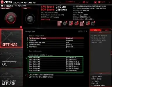

My MSI motherboard BIOS did not show "Ubuntu" nor "OS boot manager" as boot options. Instead, the BIOS had another submenu called "UEFI Hard Disk Drive BBS Priorities". Inside this menu the boot order could be selected.
