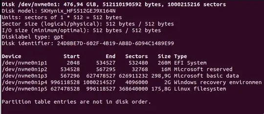

to list all your partition and disk use
sudo fdisk -l
In my case it looks like this :
Screenshot after fdisk -l
so on my computer <boot_partition> = /dev/nvme0n1p5 and <efi_partiton> = /dev/nvme0n1p1
After that run command from answer above:
