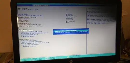

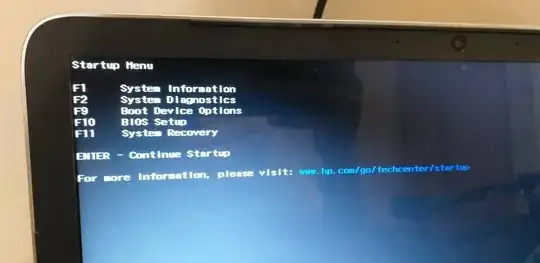

In my HP laptop, once I had a similar problem. To resolve it, I got inside BIOS mode ( by pressing ESC when the laptop was starting). Then I navigated around. I found an option where all the OS were listed. The Windows on top, and Linux was on the 2nd place. I put the Linux at top. I saved the settings and exited. From then, I would see the GRUB menu at boot up time. Now if you don't see Windows in the GRUB, try this. Inside Linux, fire up your terminal and run the command:
$ sudo update-grub
This refreshed the GRUB menu list and brought windows in the options. This is how I had resolved the issue. Hope that works.
Edit

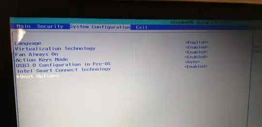

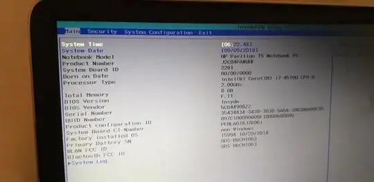

On my laptop, it was: ESC during starting > F10 > navigate to System Configeration > boot options > UEFI Boot Order > OS Boot Manager. Use up and down keys to select Linux, and use F5 and F6 to put Linux on the top. Then press F10 to save and exit. ( Check the images to be clear). Please note that these options may differ if you have an older or newer BIOS. But the procedure should be almost same like this. Good luck.
