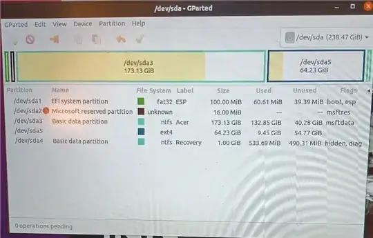

I can no longer access the Ubuntu OS even though I can see it with GParted. sda3 is Windows OS and sda5 is Ubuntu OS.
GParted screenshot
