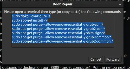

I followed this link: Can't boot into Ubuntu in Windows 10 / Ubuntu dual boot
Specifically this step: Converting Ubuntu into UEFI mode. This was because I believed that ubuntu was in BIOS mode, and I knew that windows install was in UEFI mode because I had reinstalled the BIOS for my motherboard before installing Windows.
Following the step ran without issue, I was asked to copy the commands into terminal and agree to uninstalling GRUB. However it did not fix the problem. After the first attempt of boot-repair using the Converting Ubuntu into UEFI mode step, I got the logs before my second attempt of using boot-repair: https://paste.ubuntu.com/p/hQM3shyktn/

The default repair of the Boot-Repair utility would purge (in order to fix packages) and reinstall the grub-efi-amd64-signed of nvme0n1p2, using the following options: nvme0n1p3/boot/efi Additional repair would be performed: unhide-bootmenu-10s use-standard-efi-file

All attempts at using the boot-repair in default mode or repeating the Convert Ubuntu into UEFI mode resulted in an error during boot repair.
File &quot;/usr/bin/glade2script-python3&quot;, line 2319, in set_widget
exec( arg )
File &quot;&lt;string&gt;&quot;, line 1
self._label9.set_text('''sudo chroot &quot;/mnt/boot-sav/nvme0n1p2&quot; dpkg --configure -a\nsudo chroot &quot;/mnt/boot-sav/nvme0n1p2&quot; apt-get install -fy\nsudo chroot &quot;mnt/boot-sav/nvme0n1p2&quot; apt-get install -y grub-efi-amd64-signed shim-signed linux-headers-generic
SyntaxError: unterminated triple-quited string literal (detected at line 1)
I think I messed up the boot-repair and I might not be able to salvage the ubuntu part of the dual boot.

I was running Boot-Repair from my regular Ubuntu installation because I had somehow messed up my boot setup by running Boot-Repair from Ubuntu installed on an SSD connected via USB. Running Boot-Repair from the USB drive had left me unable to boot my regular installation without the USB drive plugged in, and even unable to run an Ubuntu live USB.
Running Boot-Repair from my regular install, it prompted me to purge grub and shim signed via the terminal, which I did:
boot-repair purge prompt
After doing as I was told, Boot-Repair served me up a most vexing instruction:
boot-repair _label9
Entering "_label9" into a terminal does nothing, of course. So there I was having removed grub and shim signed, which freaked me out because I figured my system would be unbootable. After reattempting Boot-Repair several times and trying all sorts of things to no avail, what finally worked was reinstalling shim signed and grub via the following:
sudo apt-get install shim-signed
sudo apt-get install grub-efi-amd64
Then when I tried Boot-Repair again, I had the option the uncheck the box to purge grub when reinstalling, which had been off limits on my previous attempts, despite grub already having been purged. This time Boot-Repair ran to completion with no issues.
A bit more background on how I got here: after manually cloning my partitions to a new drive via some combination of GParted and Ubuntu Disks, I upgraded from Ubuntu 20.04 to Ubuntu 22.04, but after upgrading to 22.04, I kept running into problems with shim-signed whenever I would try to upgrade some things, and when I tried to upgrade to Ubuntu 24.04. I tried everything I could find in the forums, like adding the correct flags to the boot partition using GParted, and finally resorted to Boot-Repair. Moral of the story, be extremely careful with Boot-Repair! Side note: don't check the repair filesystems option if you have any Veracrypt partitions on the drive.
