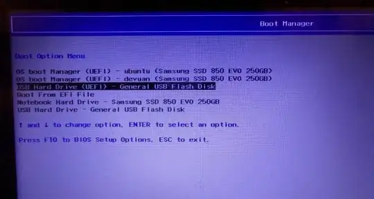

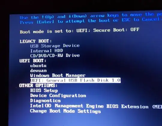

Here are two examples of what a 'one time boot menu' can look like (with the USB UEFI option highlighted):
One-time Boot Menu on a Dell Laptop A One-time Boot Menu on an HP Laptop
--Note that there are two entries available for the USB, allowing you to boot the USB in UEFI mode or not. (The 'Not-UEFI' option is usually referred to as 'Legacy Boot'.)
