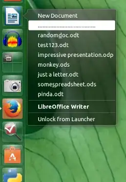

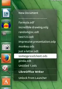

The solution adds a section to the targeted launcher in the Unity launcher, showing an arbitrary number of recently used files, e.g.:
  • show the last seven files:
  • or the last ten files:

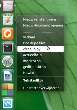

  • With the same ease however, we can give the gedit launcher a dynamic section, showing the last seven files, opened with gedit (see image further below)

As mentioned, you can easily use the script to add a dynamic "recently used" section to other application's launcher(s). To do so, see the gedit example setting for the head section of the script:
# --- set the number of docs to show in recently used
n = 7
# --- set the process name of the targeted application
application = "gedit"
#--- ONLY change the value below into "xdg-open" if you do not use LO preinstalled
#    else the value should be the same as in application = (above)
open_cmd = "gedit"
# --- set the targeted .desktop file (e.g. "gedit.desktop")
target = "gedit.desktop"
