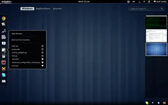

They are planned for the future, called "Jump Lists" in GNOME 3 lingo, but are currently only implemented as an extension installable at extensions.gnome.org. It should be noted that "Application menus" currently serve a similar role.
Action lists have been added to the FreeDesktop.org app launcher specification. In theory, all compliant desktop environments may make use of quicklists.
Screenshot of jump lists in Activities overlay
