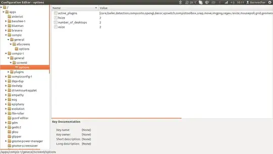

I don't know why you don't want to use CCSM. Anyway, there is indeed an alternative to CCSM to adjust the number of rows/columns in the workspaces. Install gconf-editor either from the software center or through the terminal using this command: sudo apt-get install gconf-editor
And as the picture depicts, you can edit the hsize and vsize of the workspace you have.
Alternatively, you can change the number of workspaces through terminal.
Go to the dash and open the Terminal. To change the number of rows, type the following command, changing the final number to the number you wish. Press Enter.
gconftool-2 --type=int --set /apps/compiz-1/general/screen0/options/vsize 2
To change the number of columns, type the following command, changing the final number to the number you wish. Press Enter.
gconftool-2 --type=int --set /apps/compiz-1/general/screen0/options/hsize 2
