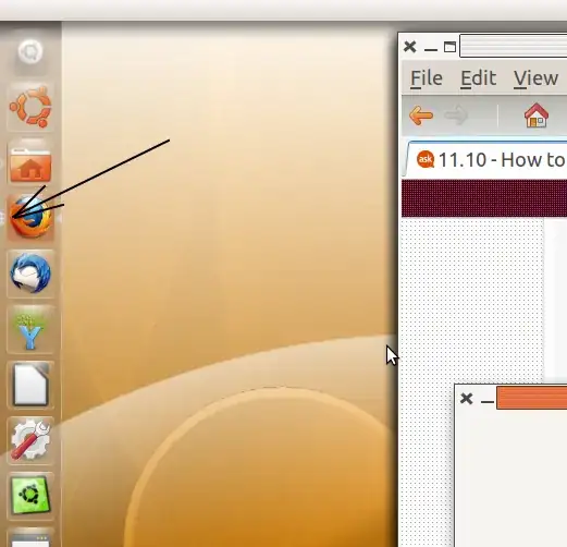

For example, I ran Firefox and opened Askubuntu. Then opened some link in a new window. As a result, I have two windows of Firefox and one icon of Firefox on the launcher. I want to have an icon for each opened window.
How do I do?

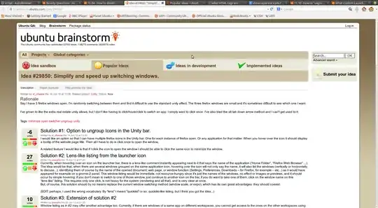

Additionally an Ubuntu Forums user has filed a request for what you ask using Brainstorm. Other Ask Ubuntu questions mentioning editing or making quicklist menu/icon for application may be possible for an advanced user but can only find working examples for gnome environment and not unity like shown here and they do not use Firefox as a working example. The Ubuntu Forums question that is referred to can be found here and the Brainstorm request/idea can be found here So go get voting!

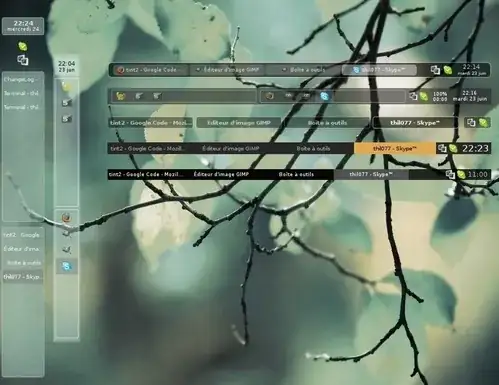

If you want a taskbar you could try tint2. works great for me.
Tint2 Website : https://gitlab.com/o9000/tint2
From Webupd8 : Tint2 is a lightweight panel/taskbar intentionally made for Openbox3, but should also work with other window managers such as Gnome.
You can install tint2 by issuing the command sudo apt-get install tint2 Then launch it through ALT+F2 and typing tint2
If you'd like to customize the position and the look and feel, there's an article on WebUpd8 with a GUI customizing tool here : http://www.webupd8.org/2009/09/how-to-install-and-configure-tint2.html

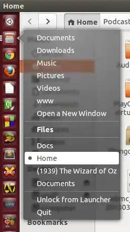

In this example, I have Nautilus opened 4 times, one Nautilus is left opened on a folder called Docs. Another is opened pointing to HOME. Yet another is opened showing the Documents folder. One last Nautilus window is opened on a movie I have. By right clicking on the Nautilus icon I can easily switch between them by simply clicking on them. The window will maximize and gain focus, leaving me with a Window I can start working immediately.

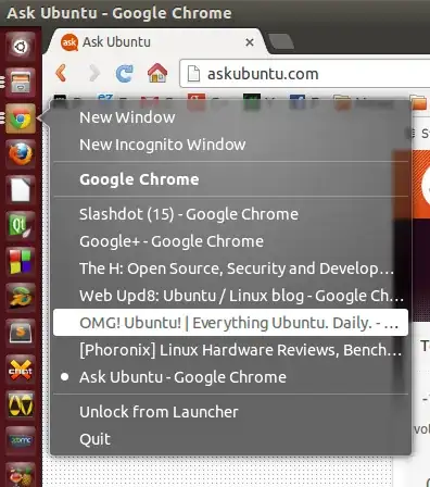

CHROME
Here you can see the same example. Many Chrome Windows opened. Each with several tabs and each one showing the exact webpage where I left them:

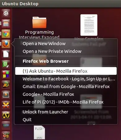

Lastly, your example, Firefox. Here you can see several Firefox Windows opened. And each Window is shown when I right click on the Firefox launcher icon:
Not only can I manage several windows of the same app quickly, but if the need arises, I can close them all with the "Quit" option in the launcher icon's context menu. Saving me time in case I had 20 Firefox Windows opened.

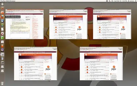

I don't know if that's possible. However, each additional window of an application will add a new tick to the left side of that application's icon in the launcher (up to three ticks I believe). enter image description here
Clicking the icon will bring up a screen of all the open application windows for you to select which one you want. enter image description here
