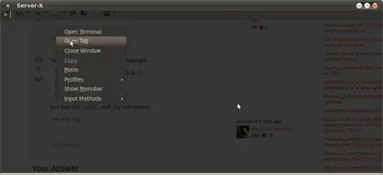

right click on mouse and select open tab.

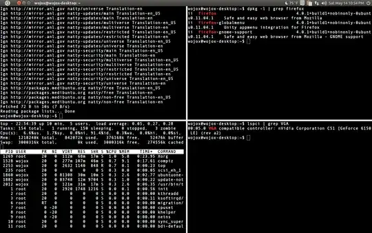

Check out Terminator as well. It's in the repo's
