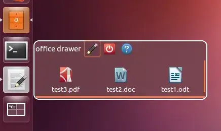

Overview
This answer gives two potential answers - Drawers and Quicklists
Drawers
Drawers is available via a PPA for 12.04:
sudo add-apt-repository ppa:ian-berke/ppa-drawers
sudo apt-get update
sudo apt-get install drawers
Launch Drawers from Dash. For you drawer, drag and drop the created icon from ~/.local/share/applications.
Launch your drawer - then you can drag and drop your favourite applications from the Dash onto the drawer.

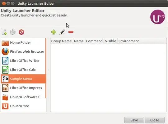

The creation of quicklist using a graphical method for 12.04 is available using MyUnity
myunity Install myunity
This option allows you to create quicklists - quicklists are a submenu that are displayed when you right-click a launcher icon.
The creation of quicklist using a graphical method for 11.04 is work-in-progress - for example - the Unity Launcher Editor
This works in Natty (ubuntu 11.04) - but due to the python version change, does not work (as at the time of writing this) in oneiric (ubuntu 11.10)
to install
cd ~/Downloads
sudo apt-get install bzr
bzr branch lp:unity-launcher-editor
to run
cd ~/Downloads/unity-launcher-editor
./ule

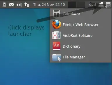

mimic XFCE launcher
The default XFCE action when clicking on the launcher button is to run an executable. For our launcher you could default to the calculator

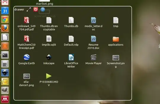

fossfreedom
  • 174,526
Drawers are a perfect way to group applications in the Unity Laucher.
As of now, it is not available in the repos but you can still install it from the ppa.
sudo apt-get update
Some screenshots to show the use of drawers
Once you create a new drawer, you can drag & drop applications from the Dash.
You can even store files and folders in your drawer, providing a way of quickly accesing commonly used files.

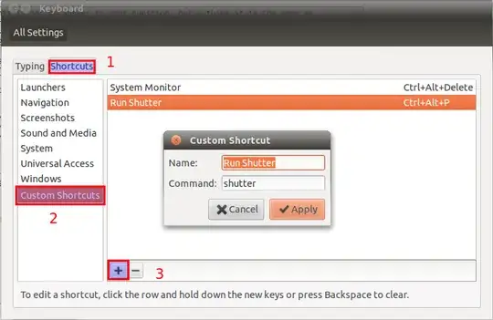

I know that this is not an answer to your question, but i think it is the same as launcher do(or simply alternatives).
1) try Gnome-Pie (an application launcher with some really cool effects) Gnome-Pie
2) Using docks, such as Glx-Dock/Cairo-Dock(such as dock in mac) and docky(they are in the software-center).
Cairo-Dock
3) Using shortcuts to open programs(write keyboard in the dash and open it >> go to shortcuts tap >> go to custom shortcuts >> press the + button >> write the program you want to open with the shortcut >> apply >> assign a shortcut to it)
shortcuts

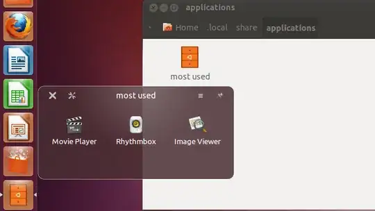

Check out a new application: Drawers enter image description here http://www.iloveubuntu.net/how-easily-group-items-featuring-their-own-mini-dash-unity-launcher-drawers
http://www.iloveubuntu.net/create-bundles-files-and-folders-unity-launcher-fancy-drawers-ppa-available
you can add the ppa by doing
sudo add-apt-repository ppa:ian-berke/ppa sudo apt-get update && sudo apt-get install drawers
Just type Drawers into the Dash to get started. It'll create a drawer launcher in ~/.local/share/applications which you can place on the launcher/dock. Then drag and drop anything you want to it (documents, folders, applications, web-urls). Left-Clicking opens up a mini-dash with icons for each file, while right-clicking opens up a quicklist. Right clicking items in the open drawer allows you to edit their name or execution command. Left clicking launches them with their default application.
