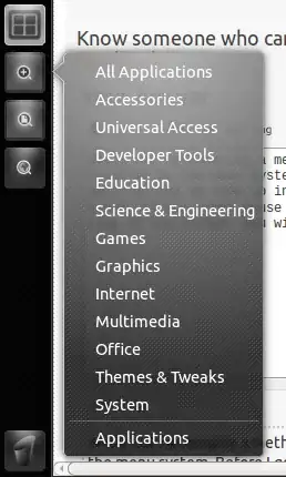

In the dropdown list of application categories wine is missing and so all wine applications are missing as well. How can I add wine applications to the application category?

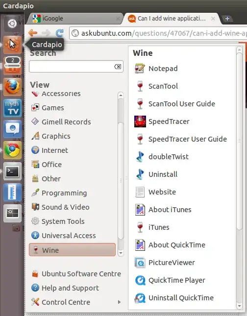

You can install cardapio which gives you a launcher that shows the original app categories.
https://launchpad.net/cardapio open launchere
