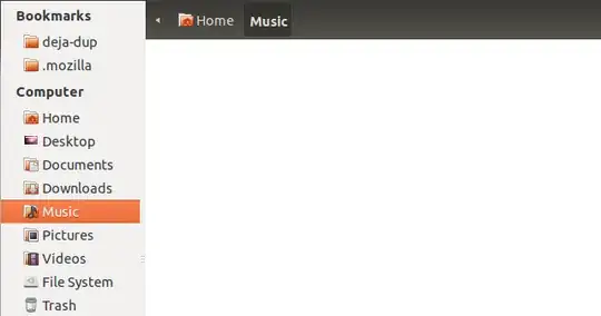

Bookmarks can be added to the left panel in the Nautilus menu in Bookmarks > Add Bookmark or just pressing Ctrl+D when inside a folder
