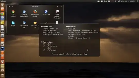

Try Drawers for an easy (drag-n-drop) way to create custom launchers. It's an app I wrote to bundle together different launchers or shortcuts for files, weblinks, etc. It's easy to edit contents names and execution lines once they're added to the drawer (right-click items and choose Edit Properties).
Here's a video I recently created to show its usage.
Here's what it looks like when you open a drawer:
Any items you add to the drawer will be available also through Quicklists (right-clicking the launcher) so opening a drawer isn't even necessary.
I will be releasing a new version shortly (13.1.1) that has a number of improvements including launching applications in terminals.
