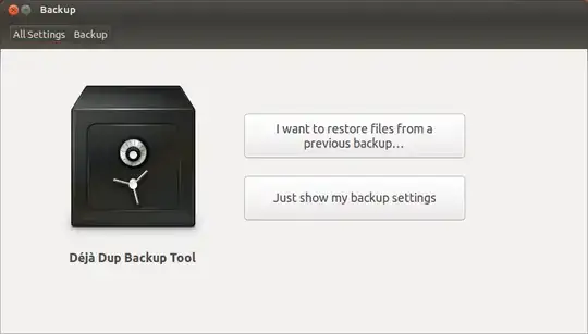

Déjà Dup Install Déjà Dup
Déjà Dup is (from Ubuntu 11.10) installed by default. It is a GNOME tool intended for the casual Desktop user that aims to be a "simple backup tool that hides the complexity of doing backups the Right Way".
It is a front end to duplicity that performs incremental backups, where only changes since the prior backup was made are stored. It has options for encrypted and automated backups. It can backup to local folders, Amazon S3, or any server to which Nautilus can connect.

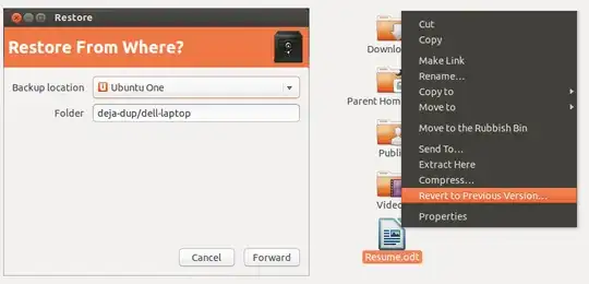

Integration with Nautilus is superb, allowing for the restoration of files deleted from a directory and for the restoration of an old version of an individual file.
Main Window Screenshot
Restore earlier version of file

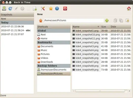

Back in Time
I have been using Back in Time for some time, and I'm very satisfied with it.
All you have to do is configure:
  • Where to save snapshot
  • What directories to backup
  • When backup should be done (manual, every hour, every day, every week, every month)
and forget about it.
To install Back in Time on Ubuntu 14.04-18.04:
sudo apt install backintime-gnome
To install Back in Time on Ubuntu 20.04 and later:
sudo apt install backintime-qt
The program GUI can be opened via Ubuntu search for "backintime".
alt text
The project is active as of August 2019.

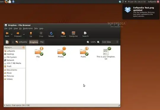

Dropbox
A cross-platform (proprietary) cloud sync for Windows, Mac, and Linux. 2GB of online storage is free, with paid options. Advertised as a way to "store, sync, and, share files online" but could be used for backup purposes too.
Note that even on paid accounts revision history is limited to one year and on free accounts it is only one month.
Note also that restoring large amount of files may be very time-consuming as Dropbox was not built as a backup tool.
Dropbox in use on Ubuntu

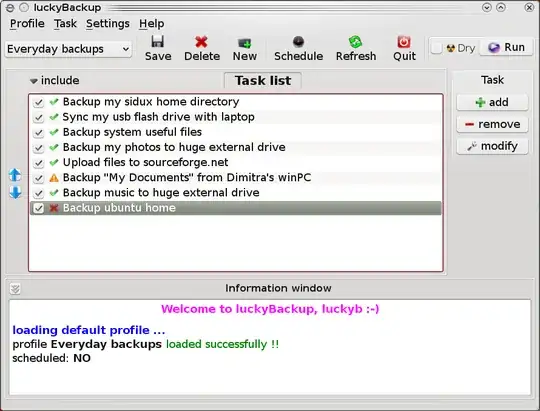

luckyBackup Install LuckyBackup
It's not been mentioned before, so I'll pitch in that "LuckyBackup" is a superb GUI front end on rsync and makes taking simple or complex backups and clones a total breeze.
Note that this tool is no longer developed.
The all important screenshots are found here on their website with one shown below:
luckyBackup
Note: As of March 2024, the last release of luckyBackup was in November 2018.

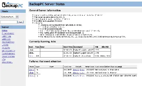

BackupPC
If you want to back up your entire home network, I would recommend BackupPC running on an always-on server in your basement/closet/laundry room. From the backup server, it can connect via ssh, rsync, SMB, and other methods to any other computer (not just Linux computers), and back up all of them to the server. It implements incremental storage by merging identical files via hard links, even if the identical files were backed up from separate computers.
BackupPC runs a web interface that you can use to customize it, including adding new computers to be backed up, initiating immediate backups, and most importantly, restoring single files or entire folders. If the BackupPC server has write permissions to the computer that you are restoring to, it can restore the files directly to where they were, which is really nice.
BackupPC Web Interface - Server Status Page

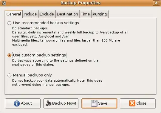

Simple Backup Install Simple Backup
Note: As of 2021-01 the last release was on 2013.
Simple Backup is another tool to backup your file and keep a revision history. It is quite efficient (with full and incremental backups) and does not take up too much disk space for redundant data. So you can have historical revision of files à-la Time Machine (a feature Back in time - mentioned earlier - is also offering).
Features:
  • easy to set-up with already pre-defined backup strategies
  • external hard disk backup support
  • remote backup via SSH or FTP
  • revision history
  • clever auto-purging
  • easy sheduling
  • user- and/or system-level backups
alt text
As you can see the feature set is similar to the one offered by Back in time.
Simple Backup fits well in the Gnome and Ubuntu Desktop environment.

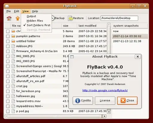

FlyBack
Warning: Unmaintained, last update in 2010.
Similar to Back in Time
Apple's Time Machine is a great feature in their OS, and Linux has almost all of the required technology already built in to recreate it. This is a simple GUI to make it easy to use.
FlyBack v0.4.0

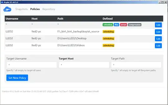

A new one is : https://github.com/kopia/kopia
Kopia is a simple, cross-platform tool for managing encrypted backups in the cloud or locally. It provides fast, incremental backups, secure, client-side end-to-end encryption, compression and data deduplication. and can do automatic backups
https://kopia.io
after comparing kopia to restic, duplicati, duplicacy, duplicity, bup, borg ... and others, I decided to use kopia primarily , but I'm using in the same time restic, duplicati and bup , so I have 4 types of backup , if one fail then I still have 3.
Install method:
GUI: linux (portable AppImage) . windows (install exe)
command line: a simple self contained portable go exe
