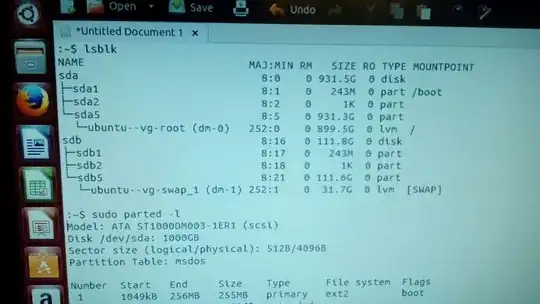

Edit2: I ran lsblk and sudo parted -l to get the following. Apologies for the screenshot. The 14 install doesn't have the right network card drivers for connectivity to copy/paste.
lsblk output parted output

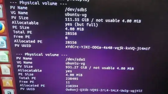

Edit 3:pvdisplay produces the following
pvdisplay output

The first thing we have to do is determine where the critical data is. Since you state that it's on the volume that contains Ubuntu 16.04 we can simply mount the usual suspects and examine the content of /etc/issue On a 14.04 install (the one you don't want) the content will be start with:
Ubuntu 14.04
On a 16.04 install (the one you want) will of course start with:
Ubuntu 16.04
In the case of /dev/sdb5 and /dev/sda5 these partitions appear to contain volume groups.
I assume you already have the lvm2 package installed. You can determine what logical volume to mount on each of these partitions and how to do so by following the guidelines in both the Q & A here.
Once you've successfully mounted the correct volume and located your data it's a fine idea to back it up. There are numerous tools available for this task. I would avoid backing up to either of the internal drives (sda and sdb) in question at this point for safeties sake and ideally backup the critical data to another drive entirely.
Once you've correctly determined the appropriate installation and backed up your critical data you can reclaim (de-allocate) the space used by the previous installation that you don't need and then simply extend the volume you wish to add space to. Or you could simply revert to your original plan of booting and running the OS off of the SSD (dev/sdb) and utiltize /dev/sda for your /home directory (data storage)
