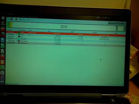

I have done lots of searches, and found lots of useful advice on partitioning the Ubuntu system so that the Ubuntu operating system (/root ?) is in a separate partition to all my files, folders, photos etc. (/home ?). I have used gparted from the live iso disk to look at partitions. None of the previous questions I have viewed have been able to answer my exact question.
My gparted screenshot looks like this;
gparted screenshot apologies for poor quality image, grabbed it with my camera).
It seems to be that the Ubuntu system that came on my laptop "out of the box" is already partitioned? With sda2 as the operating system and sda3 as the rest of the disk space for storing files etc.? Is this the case?
Do I need to do anything else to ensure files etc. are only going to the sda3 partition? Perhaps I should check mountpoints somehow?
Any advice really appreciated.

This is likely the partition scheme you have from your laptop coming with a preinstalled Ubuntu.
In your case Dell added two additional FAT32 partitions probably with custom tools which seem of little use for Ubuntu. These partition however may be needed for booting (hard to say when we dont know much of their content). As your laptop now has 4 primary partitions no additional primary partition (but still secondary partitions) can be added. This further complicates repartitioning in your case.

So, from what I can tell in your image, your setup is as follows:
/dev/sda1 is a system diagnostics partition, probably accessed by some function in your system's BIOS if you need to put it into recovery mode.
/dev/sda2 ("OS") is an image of how the system was when it left the factory. It's not mounted, but can be used to restore your PC to factory settings if needed (again, probably from some functionality in the BIOS)
/dev/sda3 is the partition Ubuntu is actually installed to (hence being mounted as /)
/dev/sda4 is an extended partition; this comes about due to a limitation in some filesystems that means they only recognise four partitions. An "extended" partition works sort of like a folder for storing more than this number. (At least, that's how I understand it. This is used here only to store /dev/sda5.
/dev/sda5 is your swap, which essentially acts in the same way as Windows' paging. It provides the system with virtual memory, and allows you to hibernate the system. I'd say it's excessively large here (beyond a couple of gigabytes of physical RAM you probably only need swap >= total RAM), but having more never hurts if you're using the computer for anything memory-intensive.
As for unallocated, this is space on the disk which hasn't been assigned to any partition, and won't be used (there'll almost always be a little left over after partitioning, but 1MB out of ~500GB is nothing worth losing any sleep over)
So, to put it briefly: yes your laptop has come with partitions - but the only one that anything will actually be stored on is /dev/sda3. If you're really desperate to, you could probably reinstall Ubuntu and repartition so that your /home folder was on a different partition to /, but to be honest I don't see this as being at all necessary.
